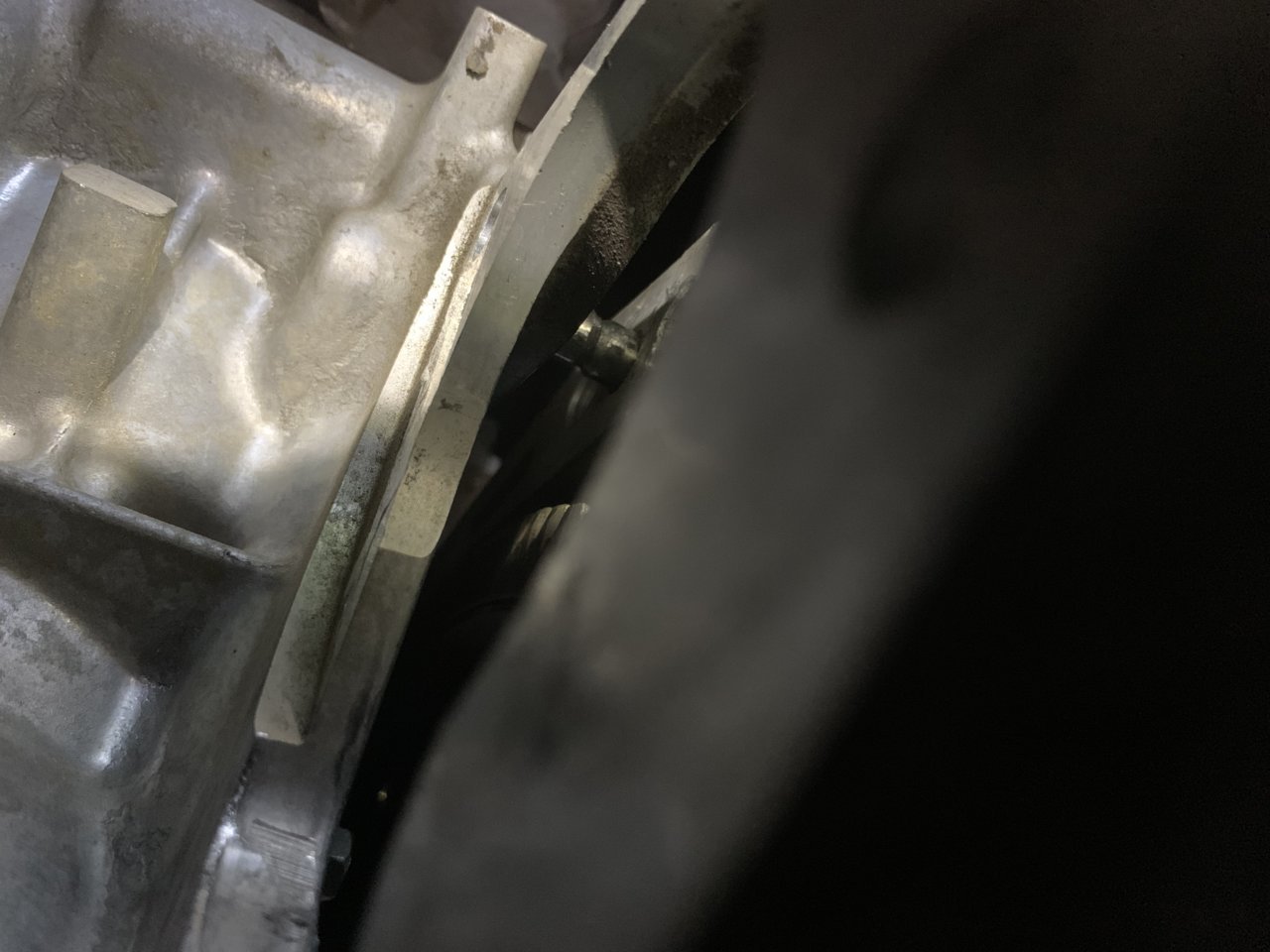

    Hey gang. Happy Father’s Day to all y’all. .. so I’m at the point of stabbing the new transmission on but ran into an issue..
    that alignment pin by the starter on engine side, I also have a pin there on my new transmission. Male to male to worky. Any ideas? Why do I have that on the transmission side? My A750E didn’t have that.

    One just got stuck. Just remove one of them.

    It does rotate. Any trick to pulling other than buying the tool?

    Grab it with pliers and pull it out.

    Wish this guy was that easy. Tried that for about an hour. It’s spins… just won’t pull out.

    vice grip pliers, worst case apply a little heat and it'll come out.

    weld a nut to it and use a slap hammer.

    Pb blaster, twist n pull does the trick.
