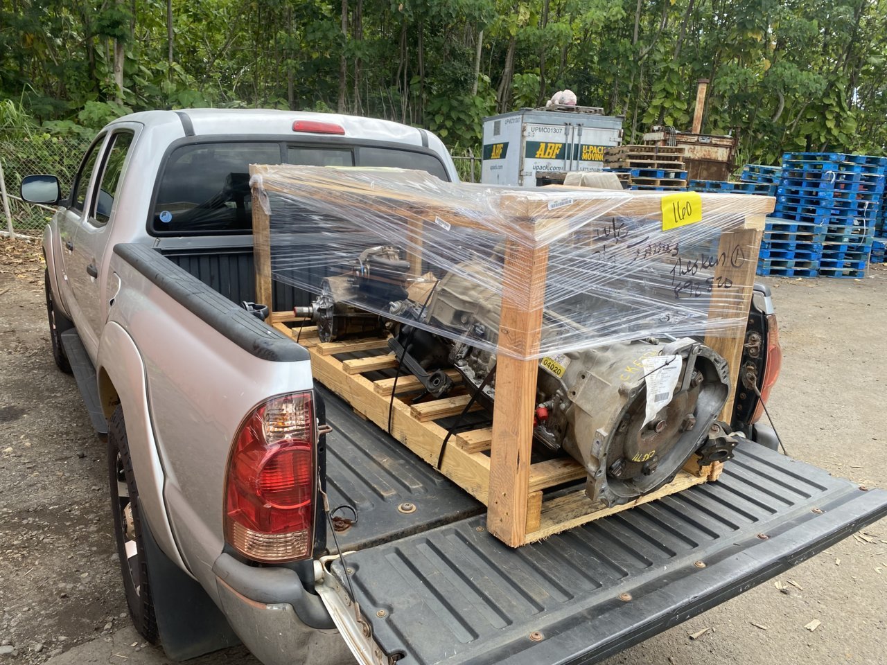

    Yeah I wanted to jump on the train before some sort of FJ transfer case shortage lol. there's a lot of little hardware pieces I need to collect now though

    First part I got was the hubs, that’s what really forced me to get everything else:D I will say it’s probably best to get the transmission as close to your start date as possible so you get the most out of your warranty

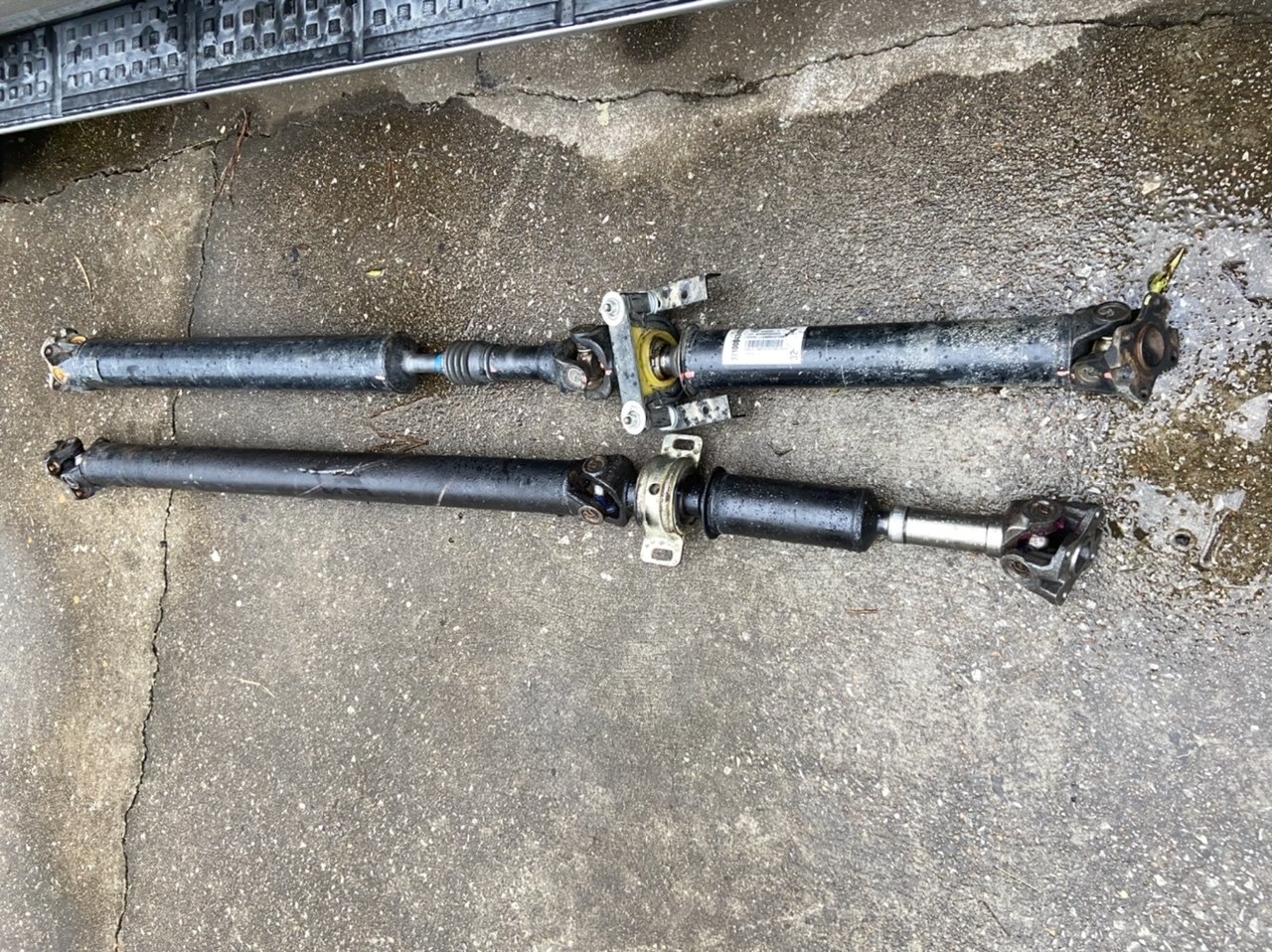

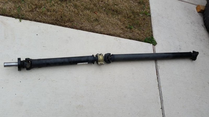

    Finally got around to shortening my shaft (twss). Took away all my vibrations!:D

    My dumbass just glazed over the stock 4wd driveshaft not being "bolt on" haha

    Lol my dumbass just realized I put the slip yoke on the wrong side. Should be the rear portion

    I might be fine tho. The old shaft had the slip yoke in the front, it just went inside the transmission. Ig I’ll find out

    You definitely need to fix it. The slip joint is needed so your suspension can articulate without binding the driveshaft. Your old shaft had a slip yoke at the transmission and another just after the carrier bearing.

    What’s throwing me off is my old one looked just like this and there’s no other slip yoke except for at the transmission. And I wheeled it pretty hard with no issues.

    My prerunner driveshaft looked almost just like the 4wd version. Just too long. But I also have a 4-cyl so it had a flange at the front like the v6 4wd.

    Yea from the little research I’ve done, Toyota designed 2 separate carrier bearings for 2wd vs 4wd. The carrier bearing is actually SUPPOSE to move in the middle on v6 prerunners to allow the slip yoke to slip. So in theory, my setup now is technically a factory setup bc I haven’t changed anything, CB still moves and the front still slips. I think I’m good. Not many people have this problem so I’m still figuring it out
    Yea when I was reviewing 4wd conversion info, I only saw the 4 cylinder people like you and @Brian422 so I just assumed my driveshaft would be the same
