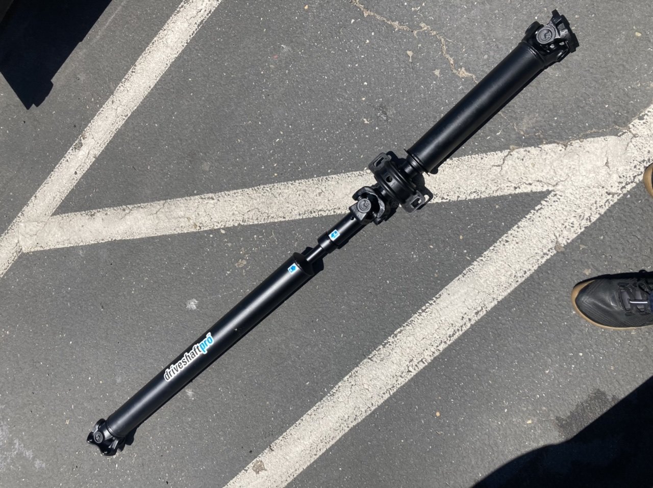

    The 4cyl one is the 4wd version just longer. I forgot why the v6 prerunner one is different but @TacoFMS explained it to me one time lol

    I’d just bolt that new one up go wheel and see what happens lol

    Your boy Right here is a 6cyl auto. U.U

    Nice that’s what I should have done lol I do see you have the same carrier bearing design that moves

    I filmed it in action. Video starts out with suspension in full droop and I lower the frame back down. Both the slip yoke and cb move. Pretty cool @ovrlndkull @Brian422

    I went the Inchworm adapter route which converts the Prerunner transmission to 4x4. Unfortunately the company that sells the adapter doesnt make them anymore forcing anyone attempting to do this conversion to buy the 4wd transmission instead which is pricier. The inchworm adapter route pushes the transfer case back about 2 inches which means I had to shorten the rear driveshaft 2" and lengthen the front driveshaft 2". Still came out cheaper than buying a 4wd trans. The driveshaft guy convinced me to just do a 1pc rear driveshaft since it had to be shortened anyways.

    Just seems like the normal carrier bearing. It will flex like that too. It’s just gonna wear out faster.

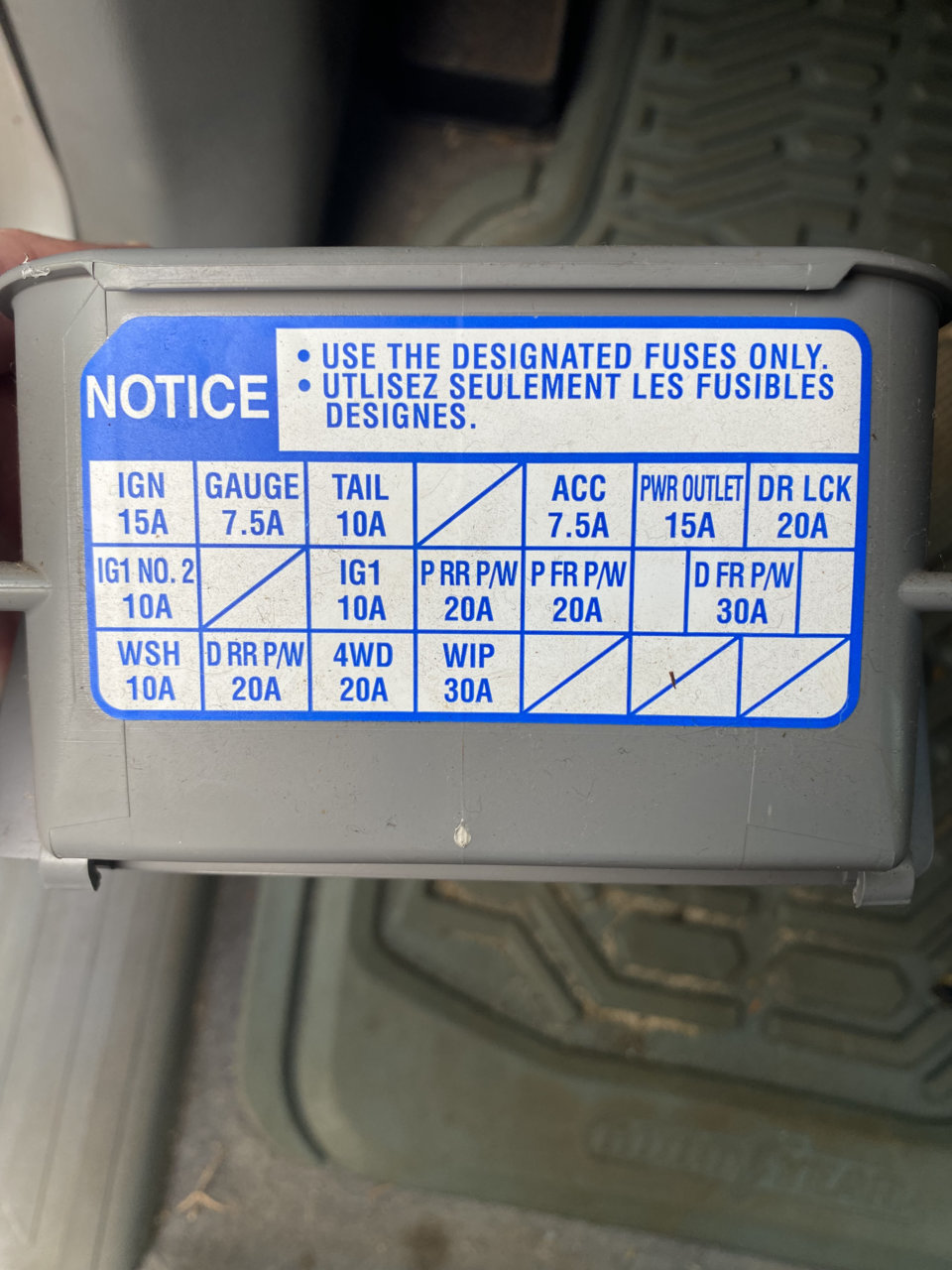

    Any tips for getting the ADD wires through the firewall? This thing is slam packed with wires lol
    Ricardo13x likes this.

    Driver or passenger side? I had already drill a 1/2 hole in my driver side grommet for some other wires. Just drill…very carefully
    jawmes[QUOTED] likes this.

    Yep driver side, that makes it easier!

    Haters btfo when they realize Prerunners are literally pre-wired for 4wd:headbang:

    Yep lol I used the 4wd fuse for ADD

    I like to use the rear window fuses since I have an access cab. Who needs rear power windows anyway.
