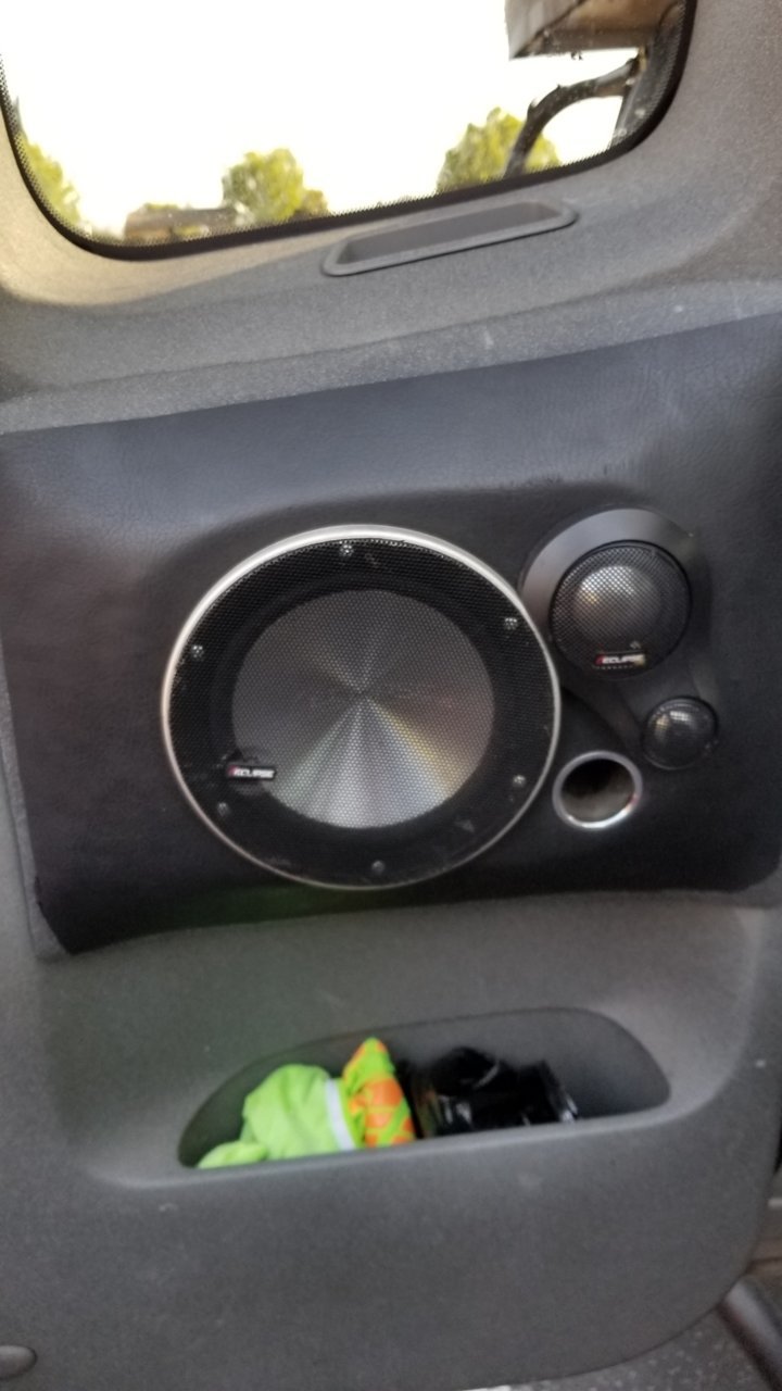

    What type of tools do you use to cut the door panel circle to fit a 10inch sub? Also, wouldn’t the sub hit the medal of the door when the suns hit?
