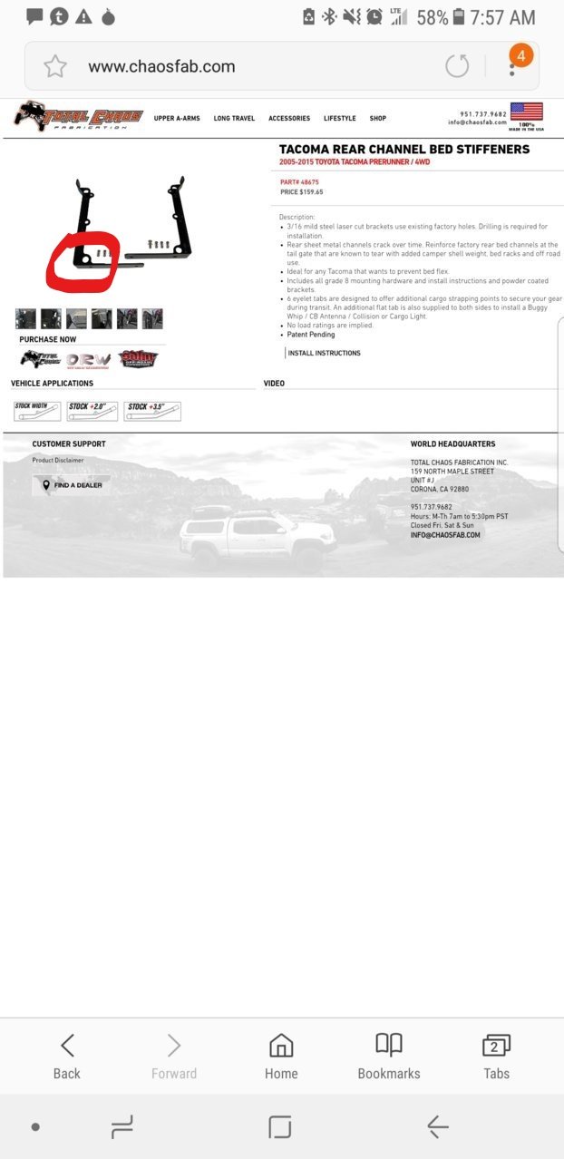

    Oh. I agree and drool over the Total Chaos stuff. The UCAs and LCAs are on my long term wish list.
    Here is what I'm talking about:
    Those corners are where all the bending load goes. There is hardly any meat on the TC ones. It also looks like it would bend pretty easily if you put a strapped on to that loop going toward the front.
    The back plates that attached to the bottom and side of the bed are there on both, but that corner sees more of the load and stress.
    A good way to think of it is how easy it is to been a 2x4 that is lying flat (3.5in side down) versus one that is standing on end (1.5in side down).
