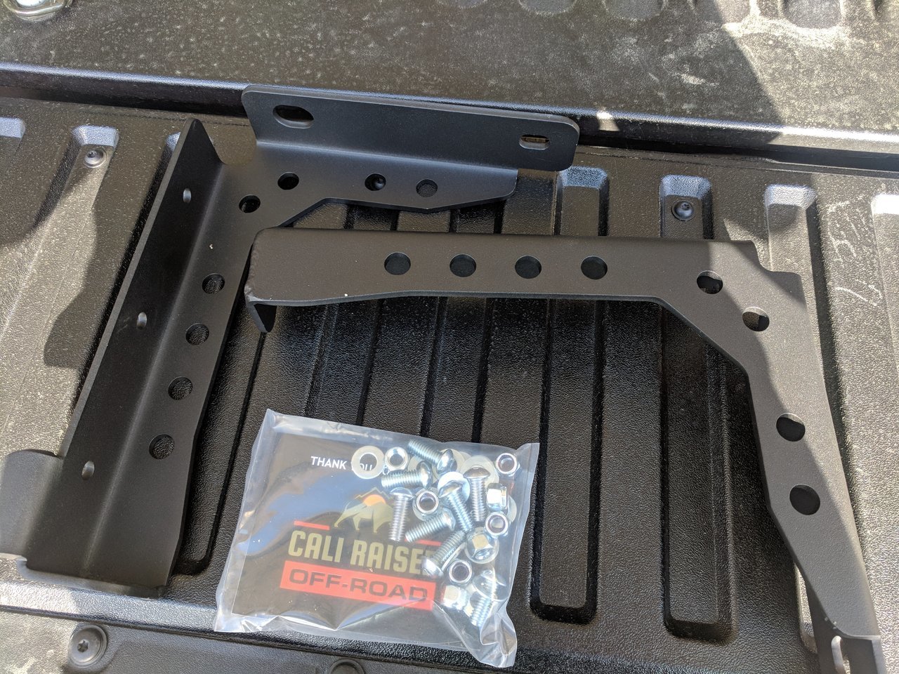

    Got em! Test fit one side and it looks good. I'll install one of these weekends when I am at my dad's shop. Plus, I need to align my bed and bumper and I don't have time for that right now ha Thanks @CaliRaisedLed

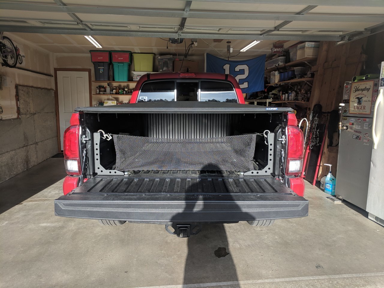

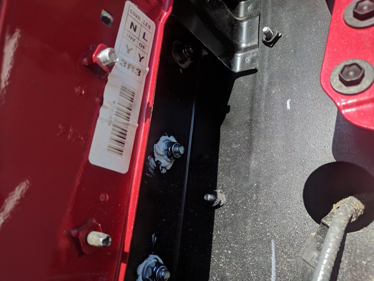

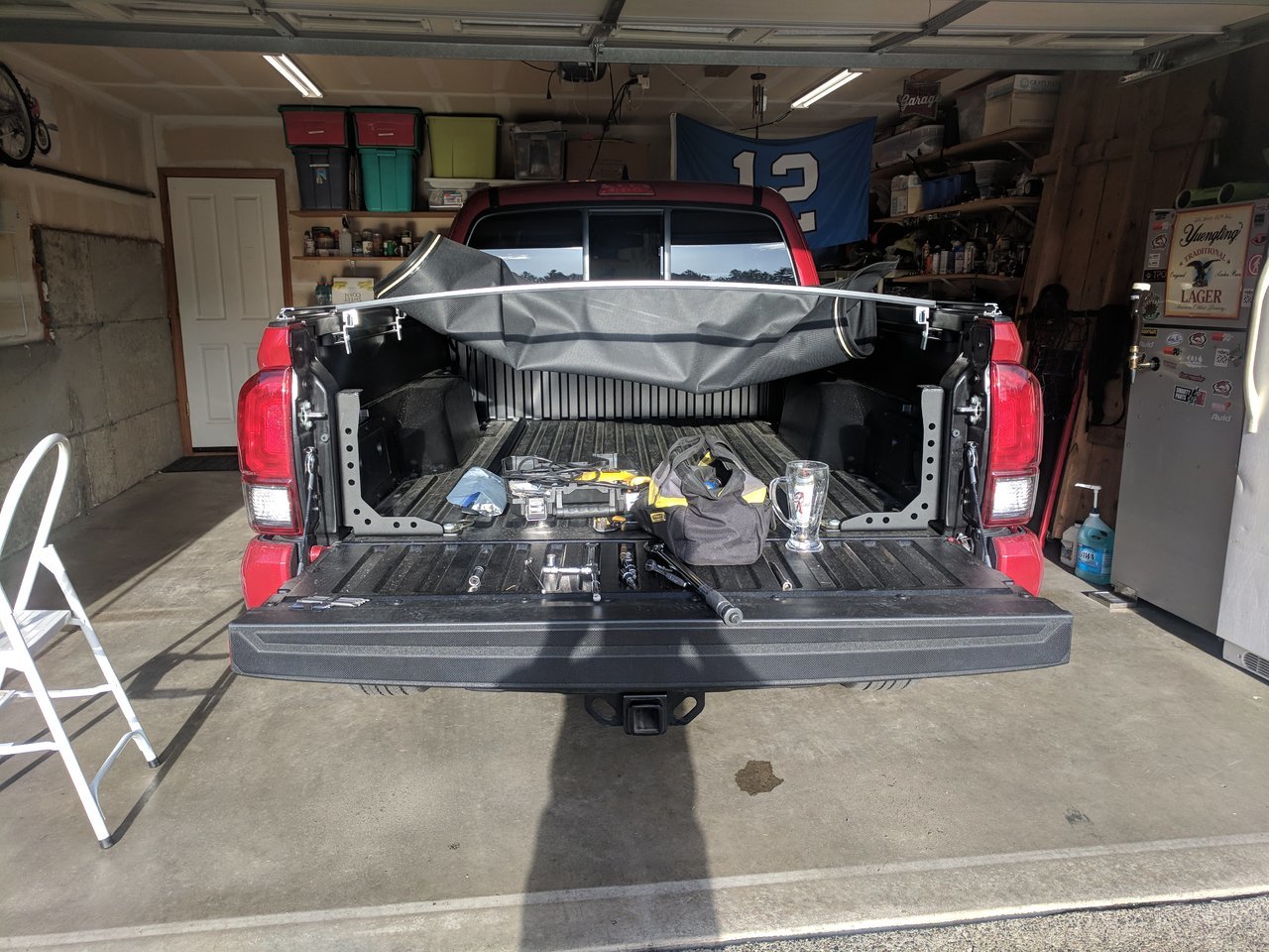

    Mine arrived and it was nice enough out (really nice), so I mounted them up.
    A couple quick notes. The hardware is SAE. I had to search for a 7/32in hex. Thankfully, 14mm fit the nuts tightly. Also, the upper hole in both stiffeners was slightly under sized. I just quickly hit them with the 3/8in bit that I used for the bed and touched them up with some flat black spray.
    Pilot holes:
    I touched up the holes with spray paint and used some sillycone to help prevent rust:
    Those top two nuts were fun to get. 14mm deep well got the top one and a ratching box end got the next one down.
    All in. I tightened the bed bolts last. 60ft-lb on the T55 and 35ft-lb on the other:
    With the stiffeners, I was able to move the cargo net that I stole from my Wife's Forester much further back:
    Good stuff! Thanks for offering these at such a great price.

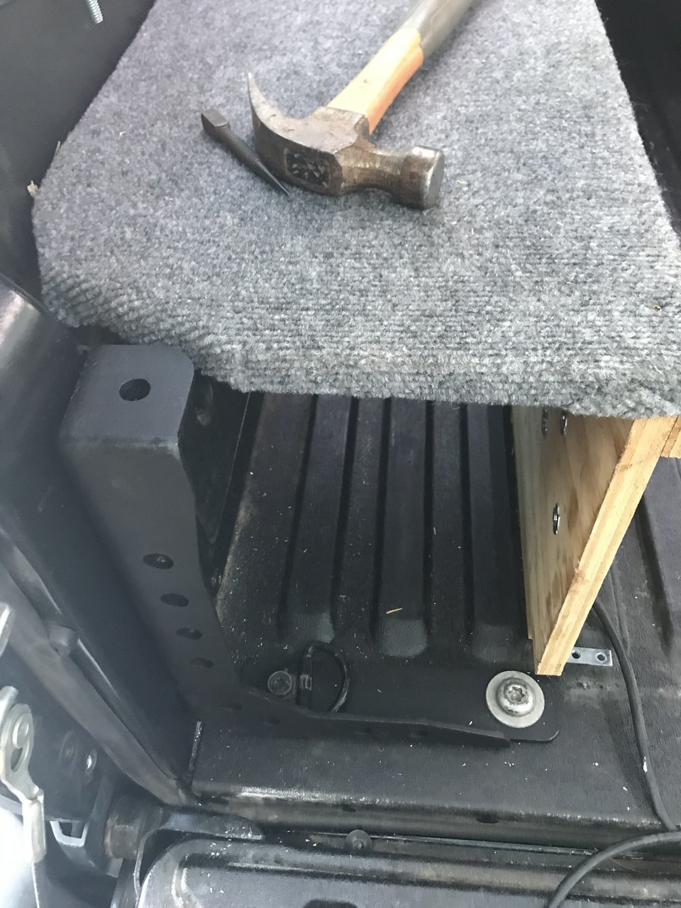

    Got one side installed today- took a while, got some extra stuff to trim and deal with.. fortunately chainsaw still fits on the driver side, just have to shimmy slightly. Unfortunately I have a 5 gallon square coleman water jug that fits perfectly on the passenger side that won't be able to stay there anymore. You can see it in the last picture.
