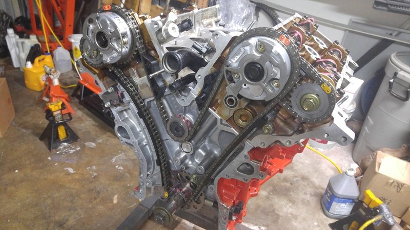

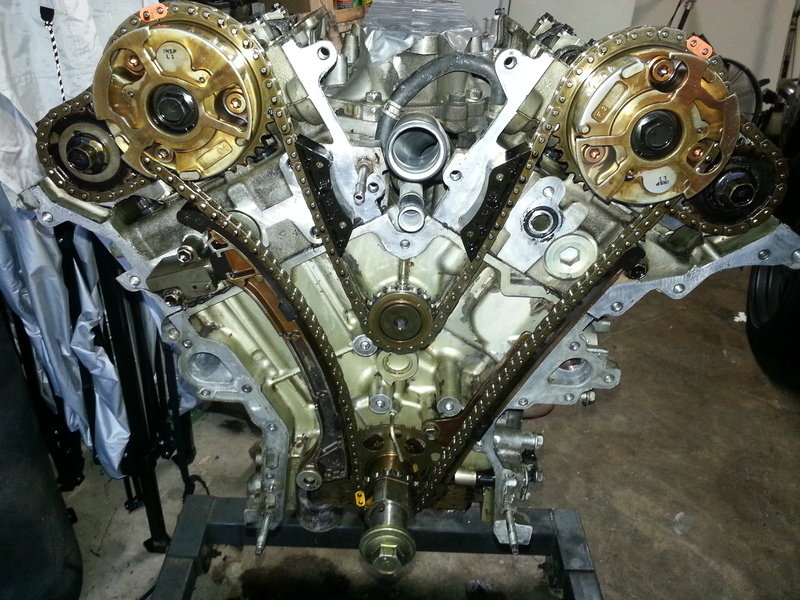

    Here are two different blocks of mine, with the timing all lined up. As a reference for the cam sensor pick-ups, on the intake cam gears.

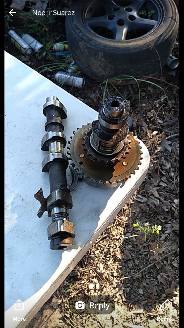

    Which one and which code did u have? My damn cam.shaft broke too .Had to get another .

    Use my picture as a reference to make sure your reluctors are in the same position, when the timing is lined up.

    Are we getting the full story here? I understand headgaskets needing to be replaced, but how did the camshaft break?
    Whatever force that acted on the camshaft (and gave it the "hairline crack" your mechanic found) may have also broken something in the vvt actuator.

    The shop told him it had a very small fracture but that it showed it was still good .idk. Then he put it on and it broke while starting. He got another and changed them out .
