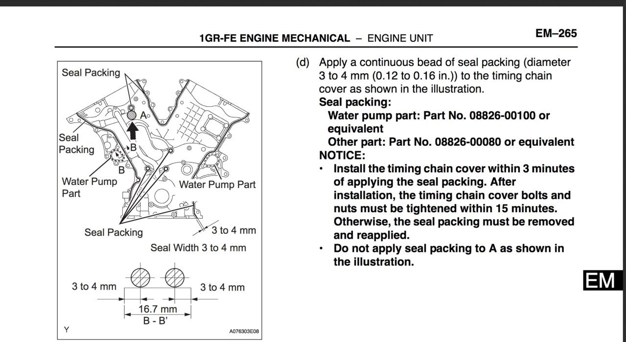

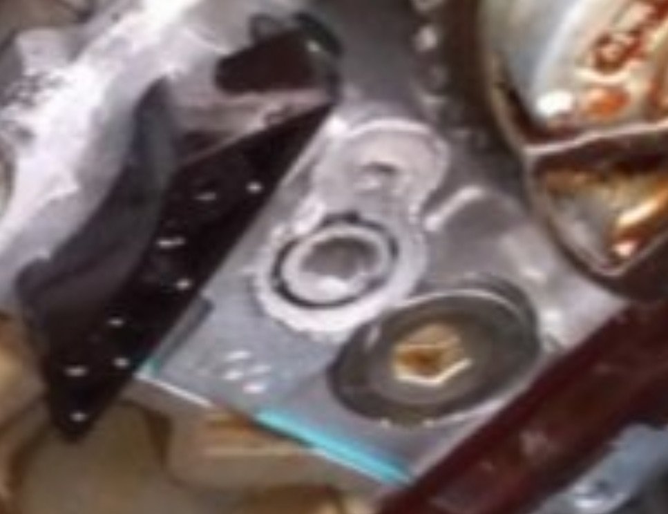

    With no pics showing timing mark indexing, I'm still unable to add much to the diagnosis other than pointing out what appears to be a big problem in the making. The blow-up pic attached looks like FIPG sealant applied to the o-ring seal at the pressurized oil passage from the timing cover into the cylinder head. This passage is the sole oil supply from the filter to the engine, and there appears to be FIPG sealant protruding into the oil flow path. If so, it's a "heart attack" waiting to happen.
    This is a big no-no, as the FIPG can detach in chunks and cause blockages in the oil system at critical areas such as bearings. The shop manual specifically says not to apply sealant to this area, see the gray-shaded circle in the shop manual procedure step and accompanying instructions.
