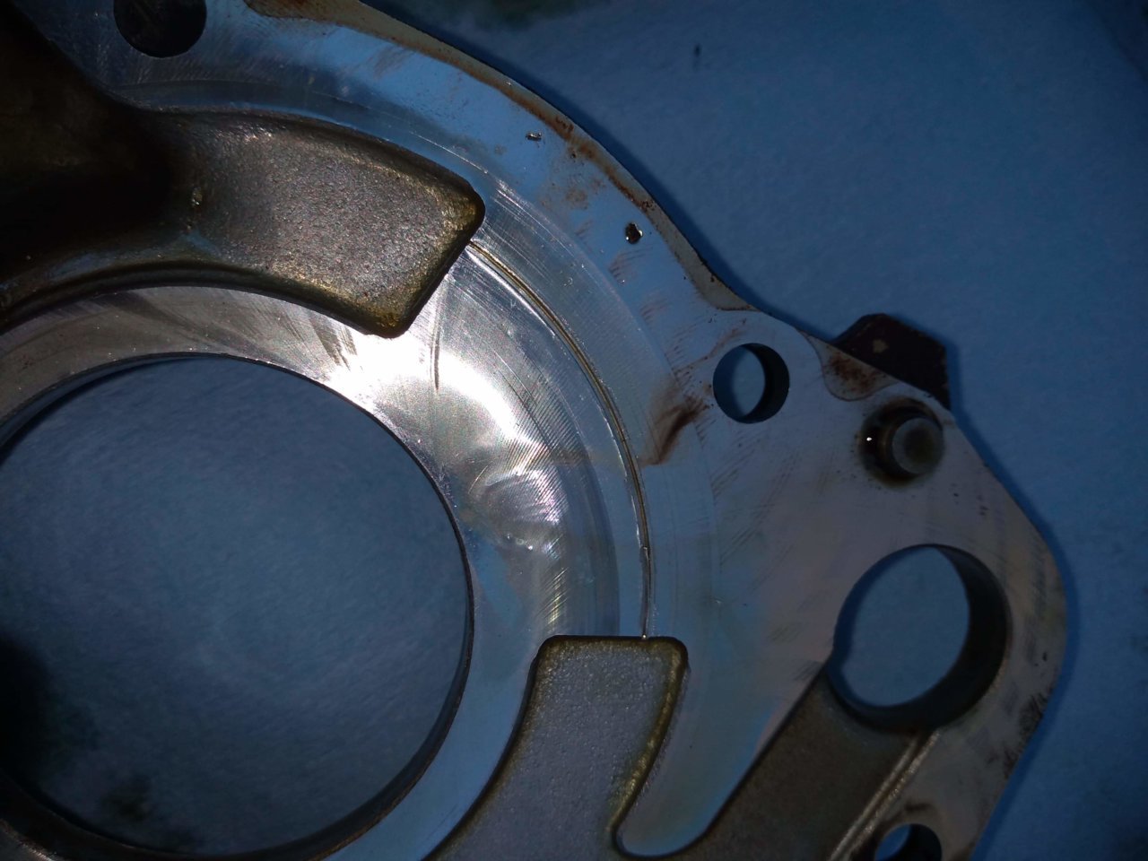

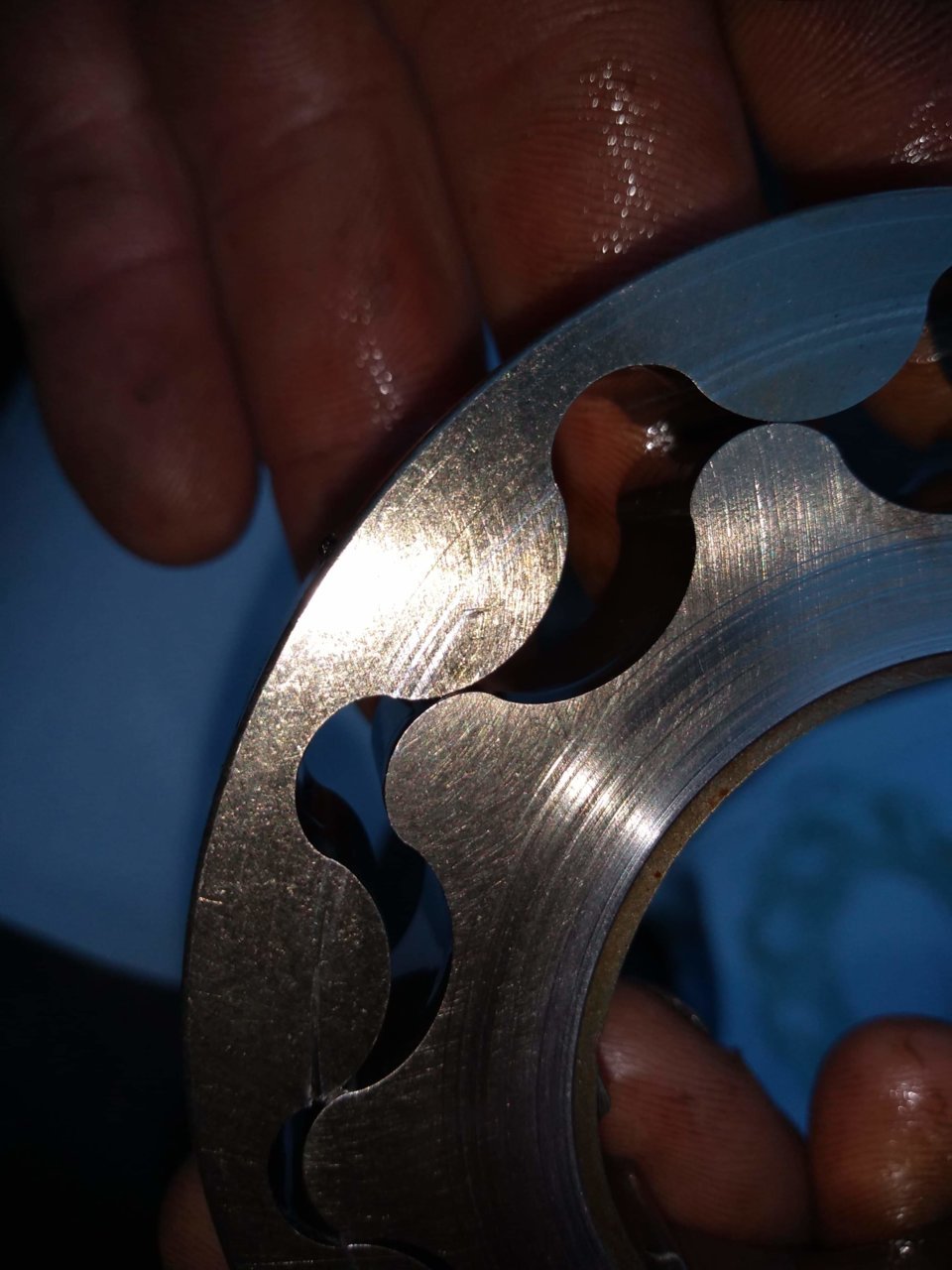

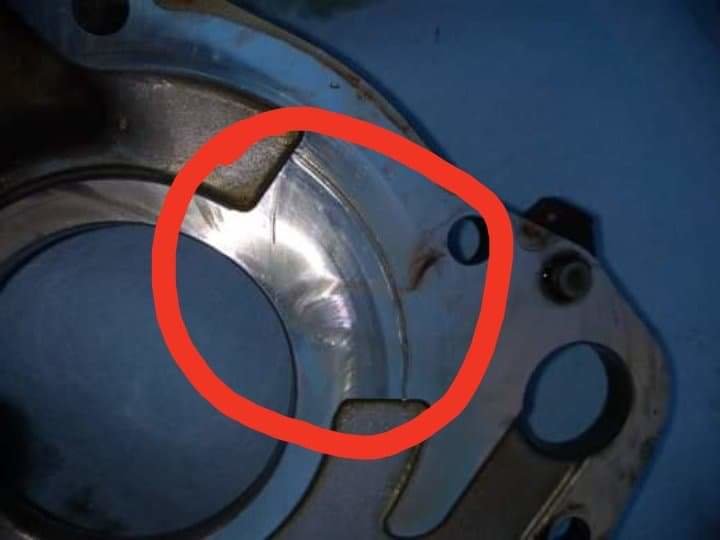

    It's my oil pump .It's fucked.
    Mechanic says there is a risk of it loosing pressure again even after putting a new one on. That it might knock right away or after a year. So now idk if I should just trade it in or still try and go on with this.

    I'm guessing that the claim is because the fixed side of the pump that can't be replaced is scored? If that's the case, bring it to a machinist, have him fill and resurface it.

    A good machinist should be able to do that by tomorrow.

    I'll agree with that. I also wonder what caused the damage to the oil pump, since the VVT was apparently working BEFORE the head gasket job.
