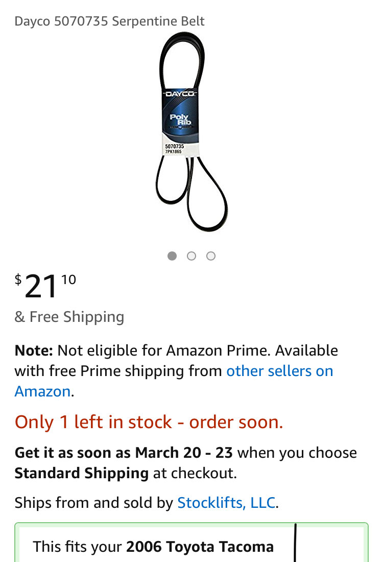

    Dayco Belt 5070735 is a direct replacement 7 rib belt intended to bypass the a/c unit. I installed it in my 06; works great! Original belt had 228k on it; still had life but my a/c failed... $22 fix.
