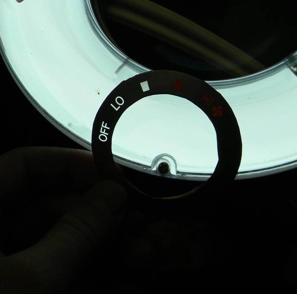

    So I found out that the amber layer can be removed with out sanding. It just peels right off after cutting the silver edges where they meet the black plastic. Just score it be a knife and start peeling it away. Use the tip of the knife to lift the plastic silver and amber layer away from the body of the dials to get it up enough to start the peeling off.
    This makes it much easier and probably cuts down this mod's time by half.

    So if I wanted to leave the housing silver could I just cut out the amber with an exacto knife (assuming I have a very steady hand) or would I still need to peel it off and make new stickers?

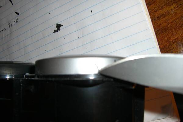

    That should work if you can get the dial face off with out bending it. Once it is bent, it will not bend back.The layer is some sort of hard plastic layer. The good thing about it is that the silver(which is very thin) is on top, then a clear layer and then the amber is on the bottom after removed from the dial body.
    So if you could get the silver dial off the black plastic body without bending it and scraped off rubbed the amber off each icon and word, you could stick it back on the black plastic body and be done.
    Another thought, since the face plate covers part of the silver dial's sides when assembled, you could take a Dremel with a cut off wheel and cut a little higher on the sides of the silver dials. This might help pulling off the silver part without bending it.
    There has to be some sort of glue in there because when sanding the thing down on the original one, when getting to the amber layer, it did not just flake off. The dial is probably glued on their with something like Elmer's glue that doesn't bond 100% but will adhere to the surface.
    Maybe a little heat to loosen up the glue is needed, but then that might melt the dials too.
    Give it a try, I hope it works.

    So I scraped off the amber from the backside, to bad I didn't remove the dials without tearing them. If you can get the dials off with out tearing or bending them you are home free.

    Yes. On the silver dial faces, it is mainly the clear layer, the silver is pretty thin and the amber color is just as thin. I ended up with some small scratches on the clear layer that is directly underneath the silver outer layer of paint. This was with the dial's face off the black plastic body.
    Maybe to separate the silver dial face from the body, you could first cut the sides and then slip a thin but hard piece of flat plastic in there to break the silver dial's from the larger plastic body without bending it.
    But I don't really know if this route will work because I ending up tearing the silver dials off before knowing the glue in there was pretty light and would just break off if worked on a little more before pulling the faces off.
