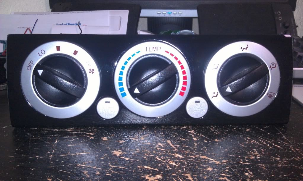

    Just thought I'd post up and say that I'm following this how-to to change the color of mine :)
    I put the center dash section from a 2012 into my 2006 and I'm now changing the color of the climate controls to match, as well as changing all the LED's over to blue. I've already change the LED's the in the gauge cluster to blue, so the climate controls and clock are the only thing I have left. Now that I have the clock out of a 2012, that'll will be a TON easier to change the color of than the older one...
    And here's my contribution; decal layouts for the models without the Max AC option! Not in a photoshop file either, just a jpeg, so you can open and print them on any machine. I'm not 100% sure about the scaling yet, but I just converted Jones files over to jpeg and then modified them, so they should be the same size.
    I would embed them into the post, but they're pretty massive, lol, so a link will have to do.
    http://i113.photobucket.com/albums/...or Change/PaintingtemplatefordecalRevised.jpg
    http://i113.photobucket.com/albums/...ntol Color Change/ControldialdecalRevised.jpg

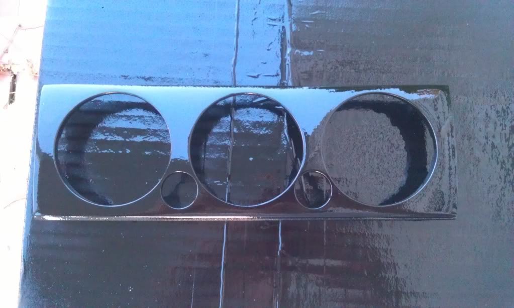

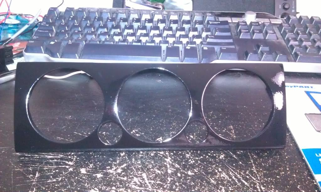

    And here's the silver bezel, sanded smooth, painted with gloss black, and letting a second layer of gloss clear coat to dry. Making the bezel gloss and the dials will be matte, so it should blend nice with the 2012 dash kit and clock above it. The paint is looking a little "orange peely", but I'm hoping it wont be too noticeable once in the truck.
    Will be working on the dials this week; have to print them out at work (I'm out of color in the printer at home, lol)

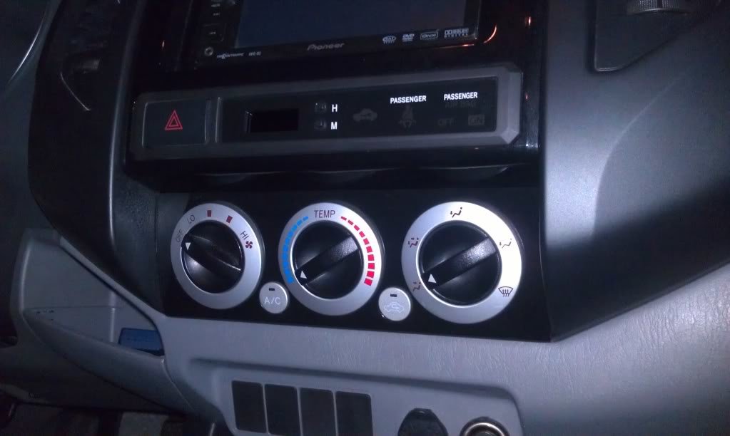

    Thanks. I work at an auto salvage yard (LKQ) and we had one 2012 come through; the ONLY 2012 I've seen come through, so I snagged the center section of the dash and the black center console out of it, lol. I only wish we'd get one in that was a double cab, because I want some black carpet; apparently they only started putting black carpet in them in 2012... Had the front of that truck not have been demolished, I probably would have gotten all the parts to change the front end to a 2012 as well :D
    I'm doing the mods to a spare climate control unit that I had also got from work so in case I horribly screw it up, I always have one to go back to, lol. But I took the newly painted bezel and put it on the still untouched silver dials that were in the truck, and I have to admit it actually looks pretty decent as it is! But I'm still going to finish off the other one I have and make the dials flat black and try it out and see how it looks; I just think it would blend in better since the radio dash kit has a flat black around the clock. Plus I'll be able to change the colors of the lighted portions, which is really what I set out to do in the first place :rolleyes:
    Here's how it looks now. I just took the pics in the dark so it's hard to see it very well; I can try to get some better ones tomorrow.
    Thanks :)
    Sorry I didn't even see the non max one, lol

    Ah I see.
    Thanks. If I still was using the 2006 parts and dash kit, I wouldn't have bothered sanding it smooth and making it gloss, but the only 2012 radio dash kits I've seen are gloss black like the one I have, so I just wanted it to match. It doesn't match exactly because the radio kit seems to have a very small metal flake look in the finish, but it's hardly noticeable enough to ever tell. Hopefully it looks good when the sun comes up tomorrow and I get a first good look at it, lol.

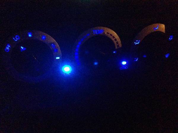

    Finished mine tonight and came out pretty decent
