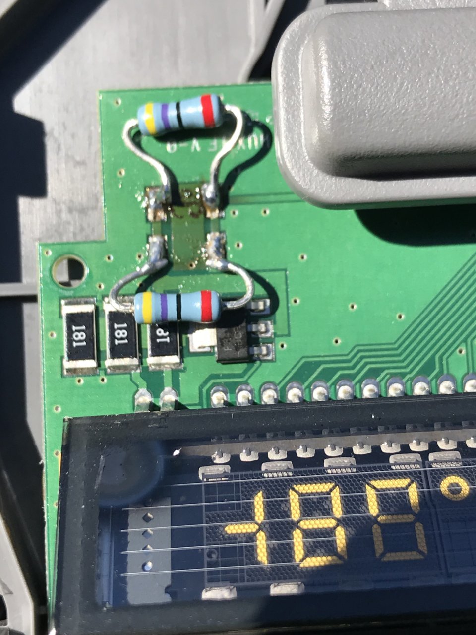

    Easy fix. Two 47 ohm 1/2 watt resistors.

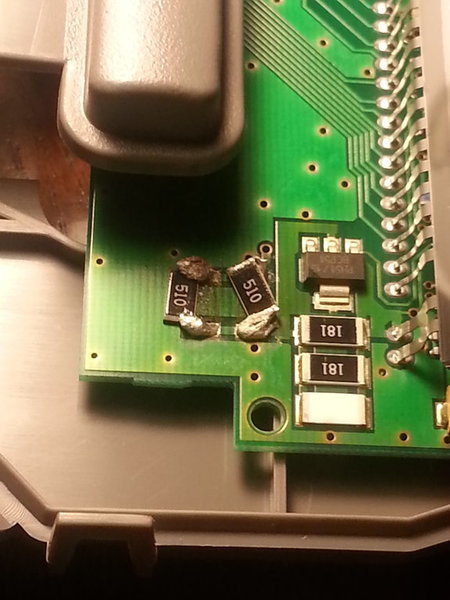

    Hey everybody. Sorry I didn’t make myself clear. My circuit board is unfixable. The repair people can’t fix it because (I’m assuming) some components are unfixable. The board needs replacing.
    There are burned areas where the previous owner must have attempted to fix it himself and ruined the board.

    Ez fix solder resistors. Bunch of YouTube videos problem is resistors get very hot and melt off. Dead board id wouldn't spend the $$$ since all that info can get from smart phone.

    Nice work. Let's see if that nicely soldered board holds up to the hack job I did a few yrs ago. Still going strong..oh yeah buddy:

    Has anyone found a cheaper solution than this? I have repaired mine 3 different times and the resistor keeps popping off after just a few months. It is not enough of an inconvenience to spend over $100 to fix but it would be nice to have.

    different type solder? I put on a ton of solder it gets pretty hot by touching it. I used the craftmans solder repaired it once maybe 10 yrs ago

    What resistor are you putting on there? You never want it it to get hot enough to melt the solder, which is why going with one of those 1/2 watt beasts up above helps.
    And what kind of solder do you have? Any decent rosin core solder ought to work.

    This is the route I took with my unsteady hand and it's still working yrs later.- uncertified soldering technician
