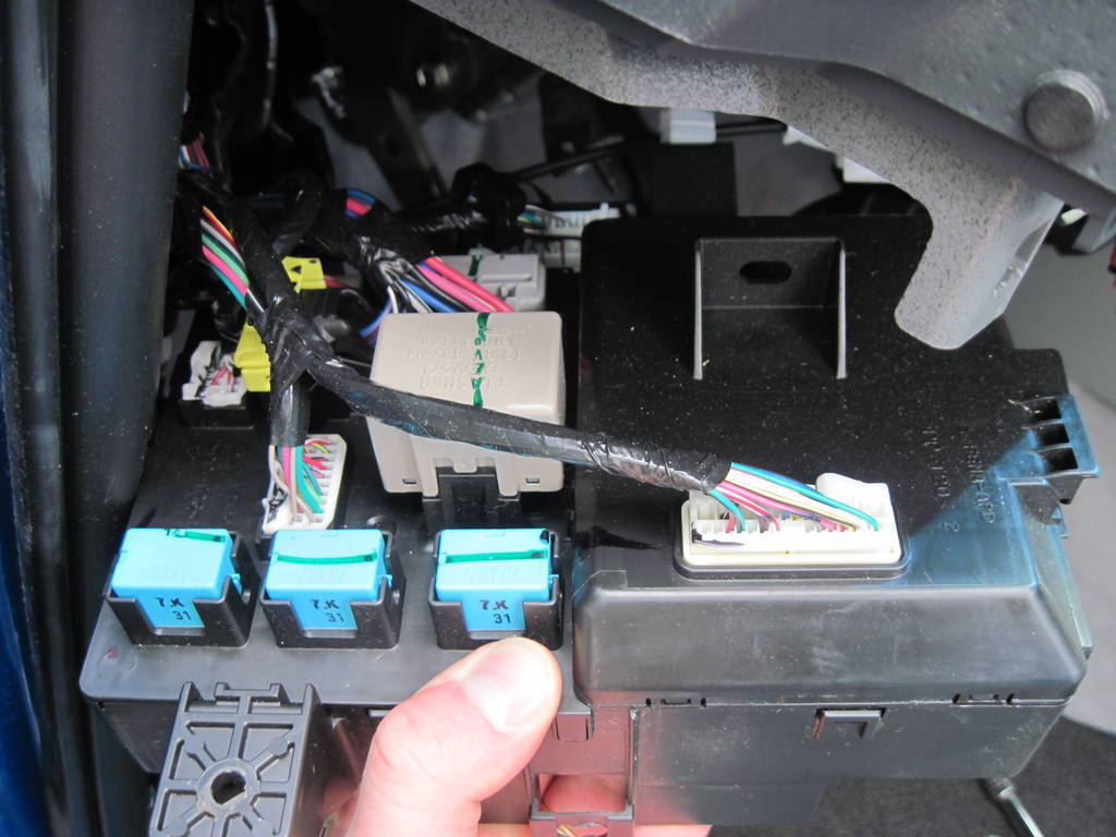

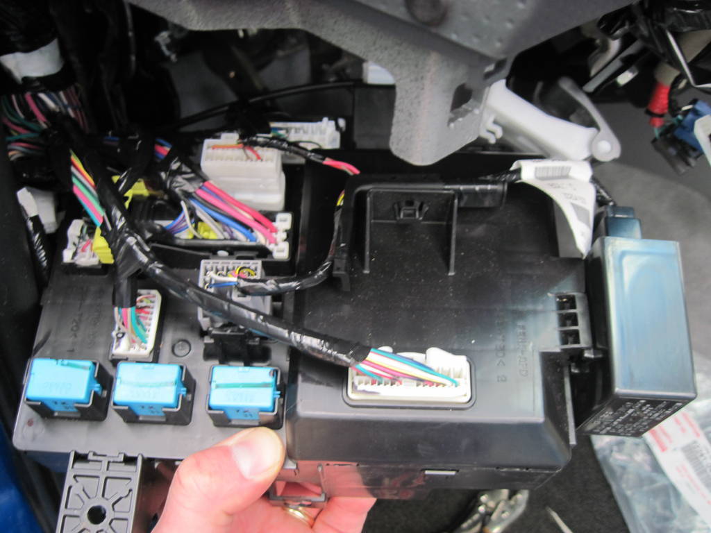

  13. Dec 17, 2011 at 6:43 AM
    #313
    Whiplash777
    Whiplash777 Well-Known Member
    Nov 23, 2010
    #46594
    51
    Upstate NY
    '09 Blue Double Cab Off Road
    Side steps, DRLs, DynoLock
    The new LED headlights should include replacements for the central turn signals. As long as you don't mind the turn signals being your DRLs, you don't need to do any wiring modifications.
    If you want the headlights to be your DRLs, then you'll need to do some wiring and experimenting.
    For reference, here's the back of the panel without DRLs:
    And here is the back of the panel with DRLs installed:
    Good luck with however you proceed and let us know how it turns out.
