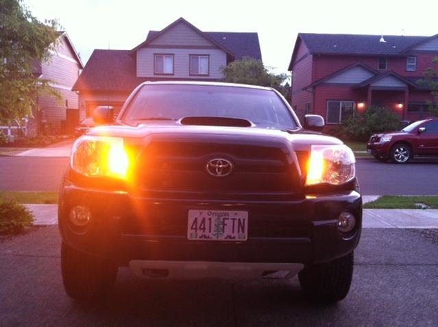

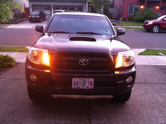

    Saw this thread and loved the look of the DRL's, I have a 2008 and didn't have DRL's (bought used), anyways, I ordered the jumper and relay and installed them two nights ago, LOVE THE LOOK! ..here's pics.. :D
    I do have 2 questions though...
    1. after reinstalling everything and reconnecting the battery, it seems my idle is running high. Is this the ECU relearning my driving patterns due to disconnecting the negative cable from the battery as others have stated in other threads? It took me awhile to do this mod because I had trouble getting the rear "gray cap fuse" out of the fuse box (longer then 45mins and I got fat fingers). Did anyone else experience this? I just feel it drives a tad differently now. Will it start to settle back into its original driving conditions?
    2. I believe this question was asked before but not answered (from what I saw) The blinker is louder then it was before after installing the jumper and relay, this isn't a really big deal but has anyone else had this? Any way to change it so the noise isn't so noticeable?
    Thanks again for the awesome mod! Lovin' it! :)

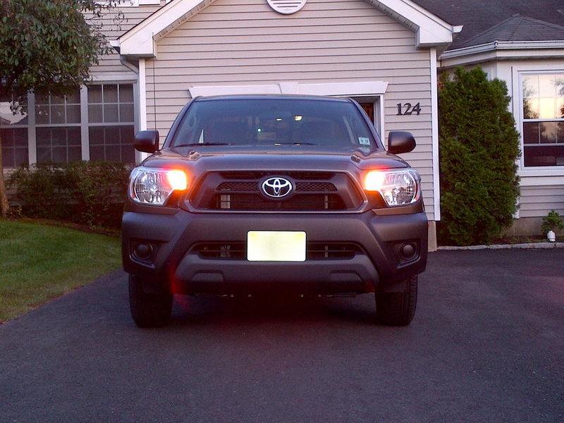

    I just did this mod using the DIY guide and no issues/problems on my 2012 Regular cab model. See attached pic. Excellent DIY!

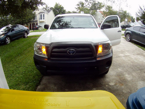

    (Picture from a GoPro)
    The only real trouble I had was removing the existing flasher from the box. But once I was able to muscle it out, everything went back into it's own plug.
    For a manual, the lights come on once the parking brake is released and don't turn off until the headlights are turned on or the engine is turned off. I keep looking at them in the reflections in cars ahead of me. They look good! :)
