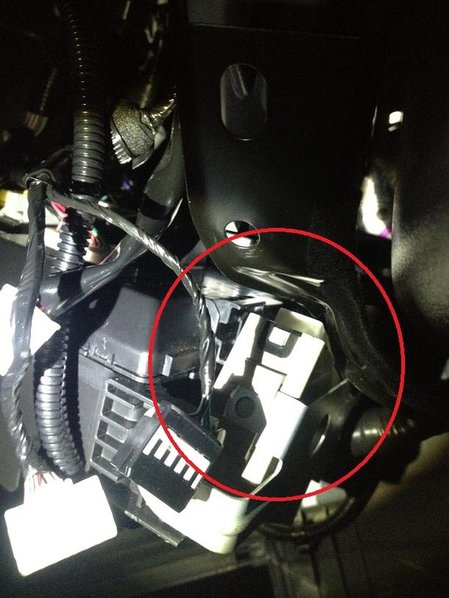

    Tried on 2012 last night,
    It has extra (Heavier' duty) wires comming from a plug located near the hood popper ... It already has a jumper and the harness has "4" pigtails not "3" like the 'replacement' part...
    So how would eliminating heavy gauage wire ADD extra lights ?
    Would i just replace the relay ?(which is also different size and location)... Was late and dark so i didnt try...
    Are you positive this worked in 2012, ? :notsure: ????

    Ill take a pic tonight, but my 2012 is auto with factory fogs v6 prerunner. There is already a jumper on the fusebox and a relay on the sidE but they are diiferent than the pics or ordered parts. My ordered parts look just like the pics on writeup, got them from trdparts4u. The pigtail ON thE truck already has 4 plugs. The ordered jumper only has 3.
    Edit just thought of something, towing package. Maybe its different for trailer lights or something.... ?

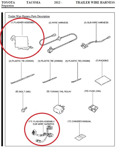

    I found this (attached JPG of PAGE 5 of the .pdf)
    http://www.google.com/url?sa=t&rct=j&q=tacoma%202012%20flasher%20relay%20part%20number&source=web&cd=5&cad=rja&ved=0CEUQFjAE&url=http%3A%2F%2Fwww.trdsparks.com%2Finstall%2FPT725-35120inst.pdf&ei=6UBmUImTEYX49gTysoDoDA&usg=AFQjCNG1oE4ekODgJF92UcR0U0hpw_Gh2w
    I was trying to see if Towing pack was differernt and I found this PDF on how to install towing package harness on 2012 (Have no idea how I found it, Google is cool I guess...)
    Listed on page 5, at #1 and #11 are my parts, stock OEM unmodified, WITHOUT DRLS. <--I was not yelling, just trying to highlight, haha... (I have 2012 Prerunner v6 Auto, factory fogs, towing package, No DRLS.)
    * Note the bracket on #1 relay, this is bolted to the side of my fusebox.
    * #11 jumper has a 4th pigtail that goes towards the bottom of the dash, near the hood popper.
    So, I have yet to see if the relay plug is the same, but the jumper is different, as well as relay size and mounting. I tried searching some auto parts places for relays to compare but no luck... [EDIT: NO, it is not the same... It will not fit, it is a differnt plug style]

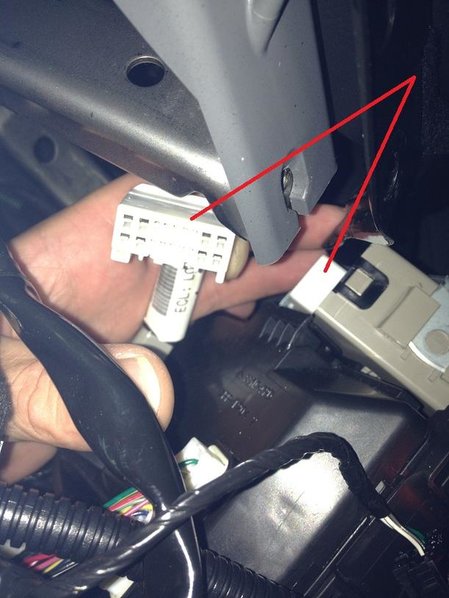

    I attatched pics of my fusebox and relay. (See the bolt-on flasher and different style / different pinout plug on jumper pigtail.)
    Note: A jumper/pigtail already exists. This is a NON-DRL truck.
    The pinout on the jumper for the flasher is different, will not work.
    Refer to the previously posted PDF. "PAGE 9" shows and explains removing the bolt-on flasher assembly and re-installing replacement to add towing package parts to 2012 drl model.
    Why the above PDF reference ? Because I have a "non-drl model w/ towing pack". The PDF is to "add towing to DRL models". (Complete reverse). The point is, my parts look exactly the same.
    Basically, no-matter DRL yes or no, or towing yes or no, the parts are different from this thread...

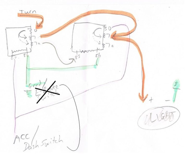

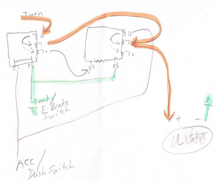

    Ok, so I "thought" I was BRILLIANT and sketched up a wiring diagram while I was "sitting" ... :rolleyes: ... (Pic below)
    ..and then I got a an email from the "parent company" of "trd parts-4-u" about the stock oem parts for the 2012,,,
    Quote:
    82241-04060 relay wire
    81980-04050 flasher assembly
    You may order these by the part numbers above through our repair/replacement parts website, www.toyotapartsales.com
    End Qoute:
    So, I am busy, I am broke. Anyone want to try the above parts for the 2012 ?
    Ohh yeah, and my diagram does this: (NOT TESTED)
    DRLs work when:
    -Truck ON. Parking brake Off.
    --The DRLs become ON. When turn signal or flasher are used, it will turn DRLs off-and-on to simulate turn signal flasher ...
    ---IF the truck is off, or, parking brake is on, all new eletrical is bypassed and turn/flashers work 100% as stock...
    ***In my head, and not on this paper, i did remove the ebrake ground from relays and moved it to acc relay (not pictured)... [So disregaurd the text "ebrake switch" notes on picture, it needs to be grounded 100%, the ebrake switching can be done on acc side (again, not pictured, OR TESTED...)]
    :cool: Yeahh ...
