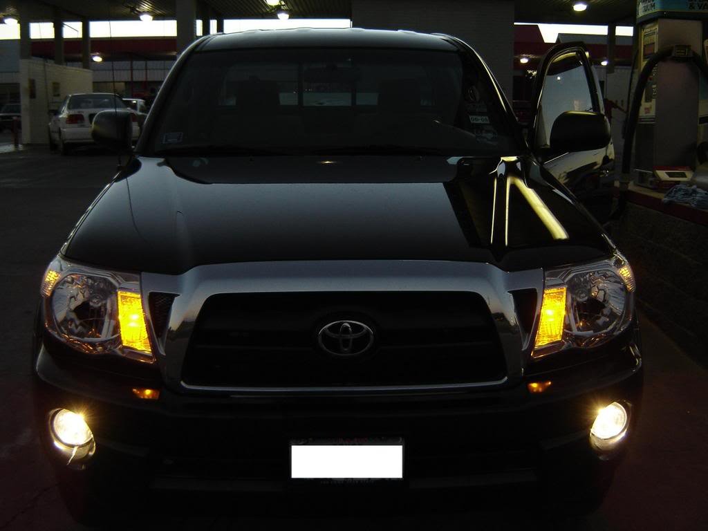

    Here are some pics. I love the way it looks.:D
