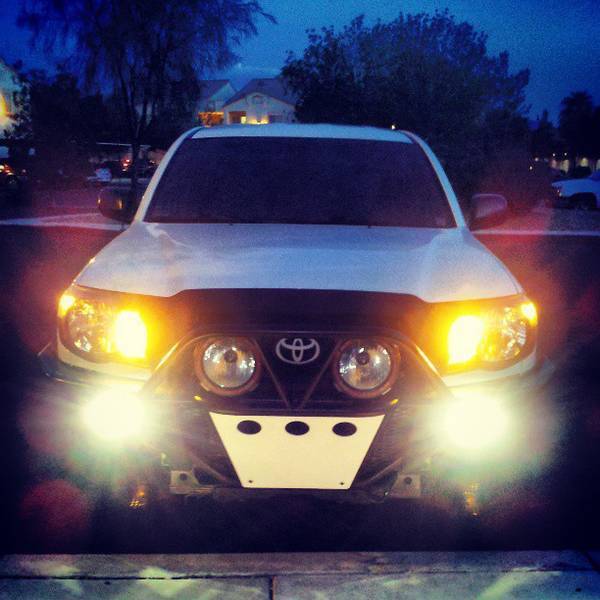

    Did this today and it turned out great. Thanks man good thread!
