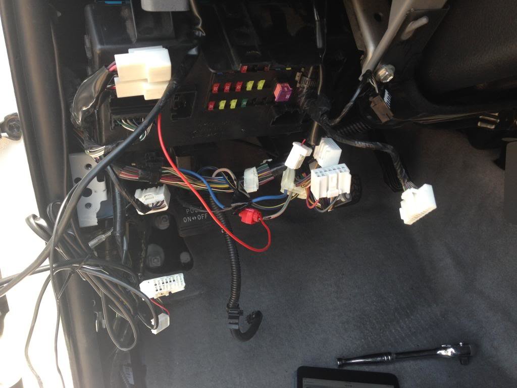

    Having serious trouble removing the relay switch on a 08 tacoma. i cant get it to budge. anyone else have a problem with this? hows it come out?
  16. May 6, 2014 at 9:51 AM
    #456
    doughboy
    doughboy Well-Known Member
    Dec 8, 2009
    #27214
    421
    norcal
    2010 Tacoma TRD 4x4
    hid head lights, hid fog lights, always on fog lights, bed lights
    there is no lock or clip to unhook, you really just need to get a grip and pull it straight out.
    I used one of these tools. just be gentle.

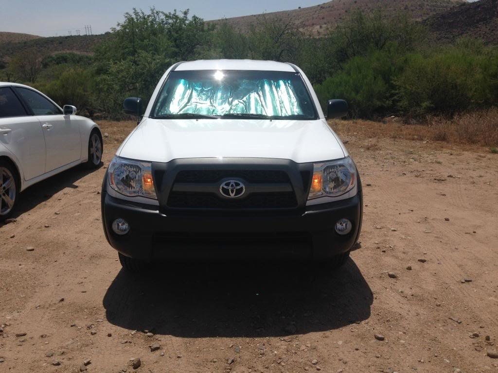

    Another success story!
    Took me about 30 minutes.
    Thanks a lot to previous posters!

    Can anyone show me what the harness looks this I'm getting someone to pull the relay and harness but am not sure how to describe it to him.
