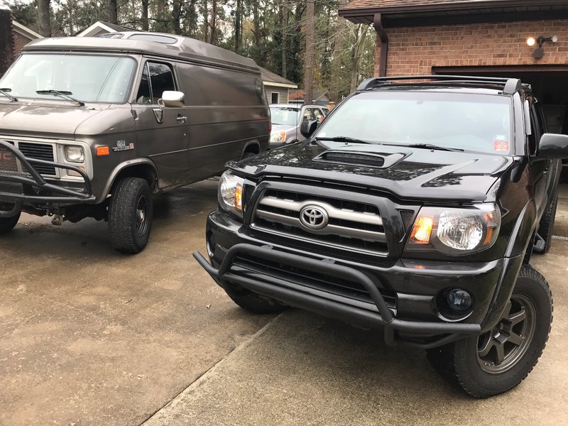

    Freaking sick write up thanks this was so easy and my truck now looks even more badass! Figured I would include the quigley 4x4 van too since it has 1986 DTRL :muscleflexing:
