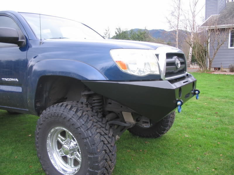

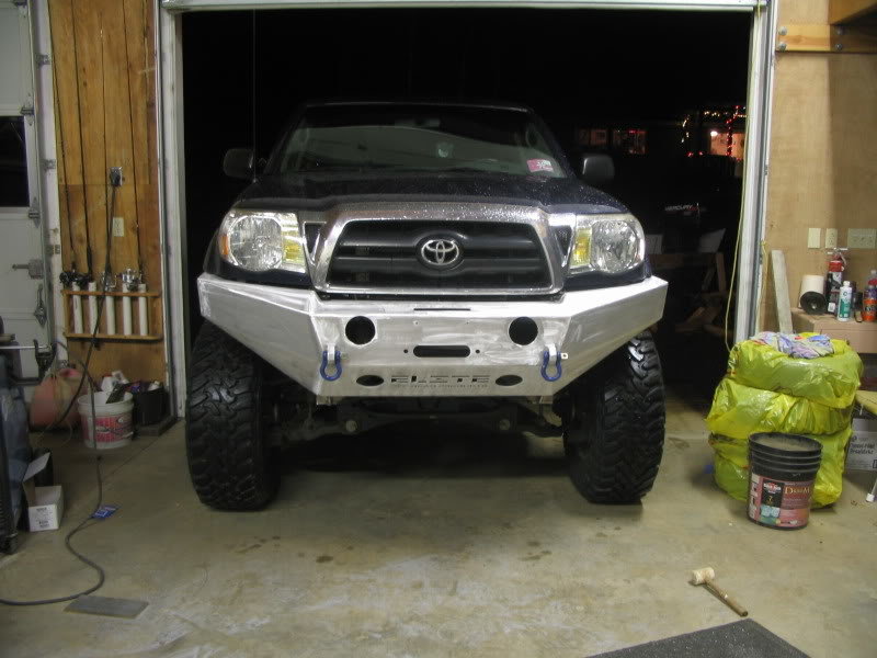

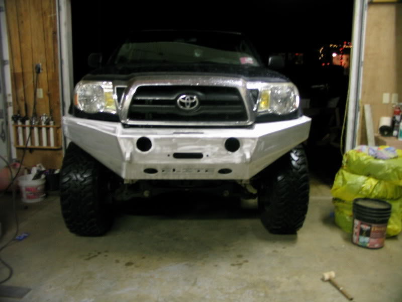

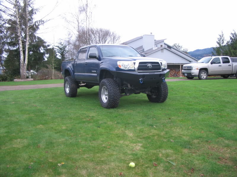

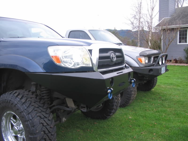

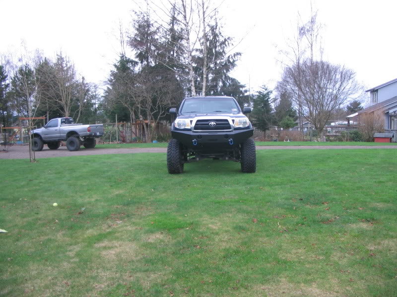

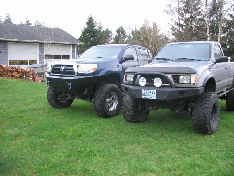

    here it is fully welded before and after painting black, this bumper is 1/4 inch aluminum and will be for sale after the new year, PM me if interested. thanks for looking
