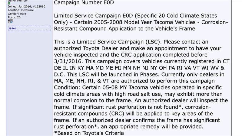

    Yes the Toyota rep told me everything I posted today. Here is a pic of the letter.

    It's being issued as a corrosion resistant compound & therefore subject to dec review & acceptance. Frame replacements if there is perforation larger than 10mm

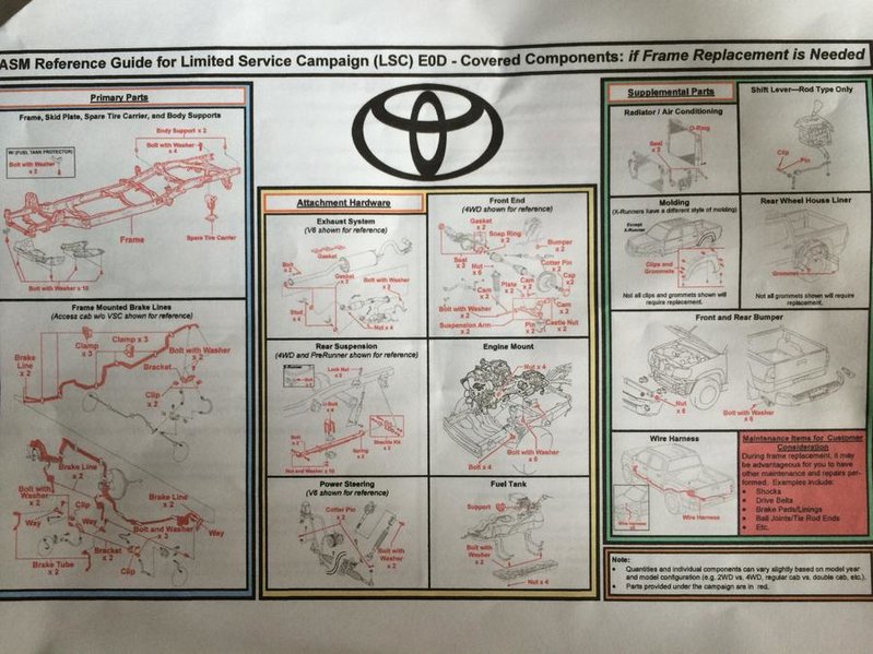

    Here is the important stuff

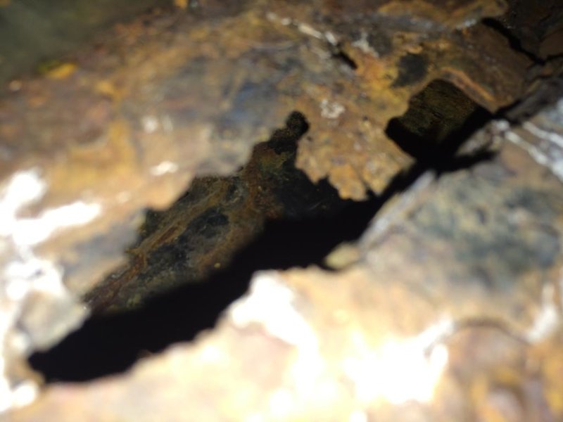

    I looked at the rot after the inspection today. They made the hole WAY bigger!!
