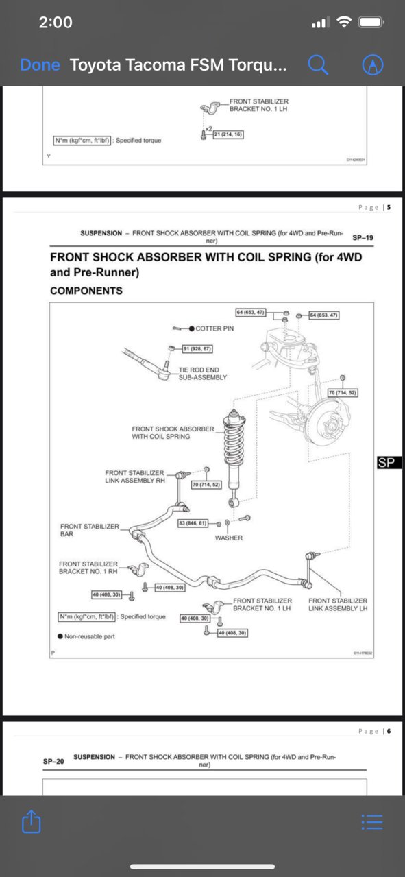

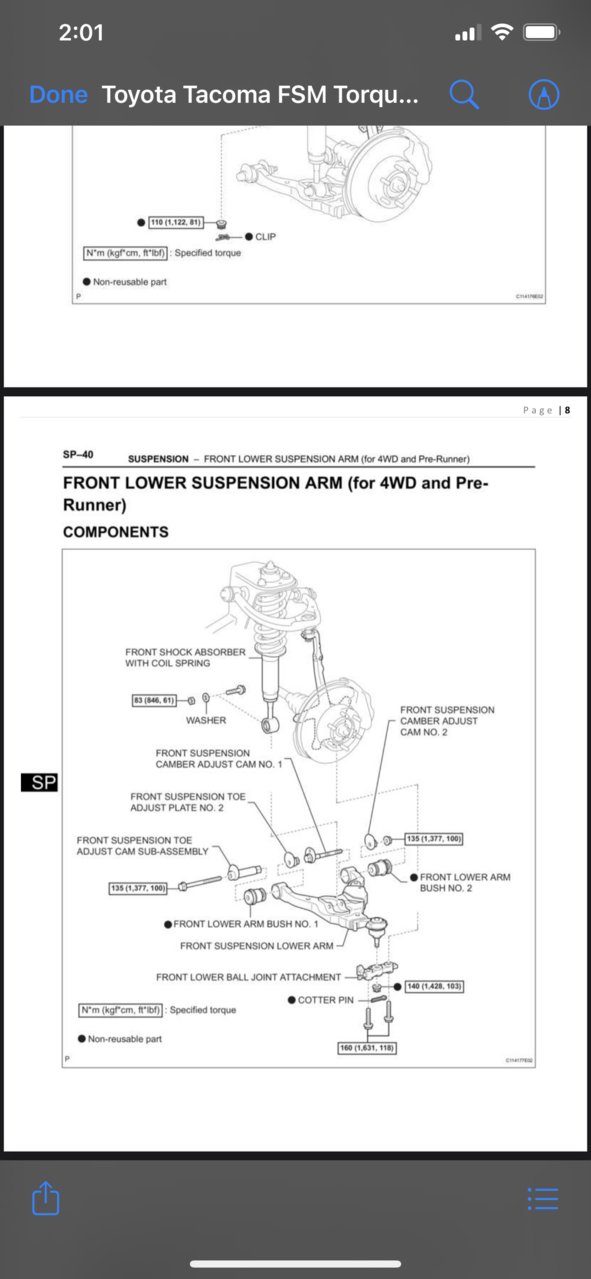

    One final thought and you might already be planning on it… I used blue locktite on those two bottom steering knuckle bolts.
    This might also help, these should be good for 2nd and 3rd gens-
