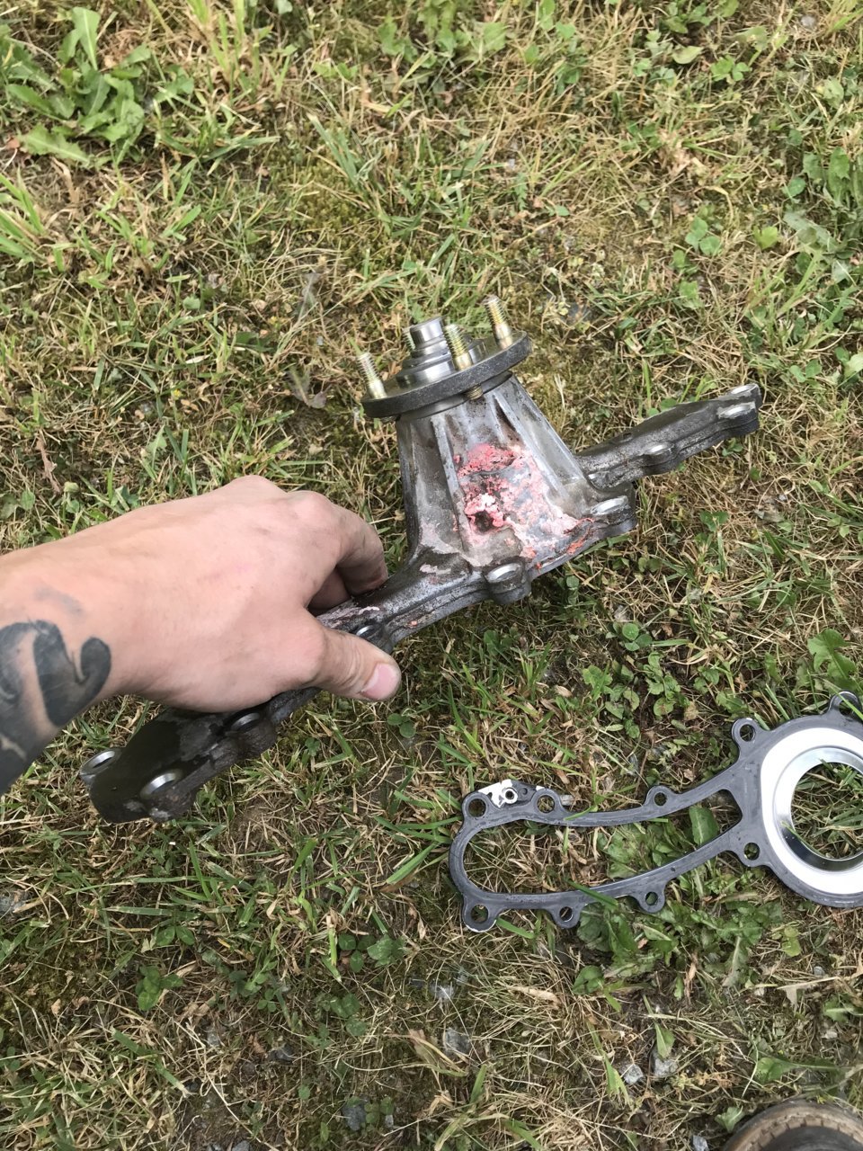

    Hello every one! I hate to beat a dead horse but here goes.
    My 05 tacoma 4.0 with 130k on it has been acting up for a few thousand miles.
    At first I noticed a gurgle behind the dash after taking off for the first time in the mornings. Than one day sitting in my truck my heater went cold, I reved it up and got heat again. Every thing had been going fine until I noticed the coolant was a little low. Topped it off and after 15 miles of driving it was bubbling it out of the over flow. I kept an eye on it for the rest of my trip and it was fine never overheated. On my way home it started to creep up slightly so I pulled over and topped off the radiator. I also checked my radiator hoses. Upper was hot but I still could hold onto it. Lower was significantly cooler. When I got home same thing but after sitting for 10 min it reversed. I pulled a compression test tonight 168-175 across the board. I’m really at a loss here. If it’s a hg issue not the end of the world but I can’t see pulling the heads with that great of a compression reading. Any chance the water pump is weak? Maybe impeller is slipping?

    Ok thanks I did notice there was a small pink crusty spot under the water pump hard to say if it’s from the weep hole or from it pushing coolant out. Every thing is covered in coolant from this.

    No coolant smell in the exhaust, I have had my fair share of 3.0’s and 3.4’s and have never saw any thing like this. What worries me is the known issue 05-06 have with head gaskets.
    I have no problem tackling the head gasket my self but every one is different. It’s just nuts and bolts right? Haha

    It sounds like your water pump is going bad. My water pump did the same thing (leaking out of weep hole) and eventually started leaking bad. About a gallon of coolant every 100mi. These water pumps are known for going bad at about 100k miles. Do not replace the water pump with a Duralast water pump. I did on my last truck (Also had 1GR-FE engine) and wound up replacing it again 10k miles later. I believe the original one is manufactured by AISIN. If I remember correctly I bought mine at NAPA for $180. Replace coolant with Toyota pink or Zerex pink Asian coolant.

    I came across a post by Lester lugnut with a procedure to pull the plugs and insert one at a time with the radiator full and see what bubbles. I’ll give it a shot. Aisin water pump will be here Friday. Thanks for every ones input. Stay tuned.

    Water pump was pretty crusty out the weep hole. Fingers crossed that it’s fixed now. Letting the air bleed as we speak. While apart I flushed and back flushed the heater core everything was nice and clean
