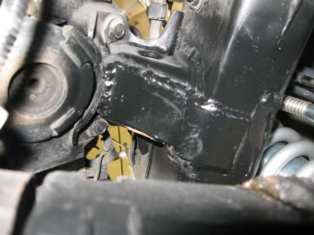

    My 05 has very shitty looking welds, and you can see they are starting to rust between the frame and the weld. My truck has 28,000mi, no jumping I can assure you. The 07- newer trucks have a frame reinforcement in this spot because of this issue, the welds are also much much beefier. There is some pics around comparing the difference, I think maybe at the beginning of this thread. As far as I know there is no difference in drivetrain from 05-present, for a V6 4x4. Frame warranty is 3 years or 36,000mi I believe. This is definitely something to keep an eye on, as it is becoming much more common on TTORA and some other sites.

    Uhh, the issue is the motor mounts failing by collapsing into the frame-- it's pretty obvious that the new plate is to fix that issue. Whatever the cause (metal being too thin, undercut welds, etc.) the plate is there for that reason.

    Oh I see, good pint, I didn't consider they were burning through the frame. So the weld is possibly to deep.

    It is quite noticeable that the main frames are made differently. The older frame has a seam in it, the newer frame does not.

    I've got an 06 built in January, and mine's the same. about 3 or 4 white paint dots right on the weld.
    Mine's only got 35K on it though, and I didn't see any signs of failure.

    Checked my mounts and the same. Mine was manufactured in Farmington, CA 04/06. no plate reinforcements, but the welds felt thicker and there are white dots on each face of the weld. Everthing looked fine at 60K miles.

    I had mine reinforced.

    i just started noticing the other day my fan was rubbing on my shroud and i couldnt figure it out, and it would get worse if i hit a bump, i checked my motor mounts they seemed ok but ill take a look again and check the welds, but this sounds like it could be a good possibility ill check mine tomorrow and if it is ill take some pictures before i fix it!! if thats the problem

    so i just crawled underneath my truck and indeed the frame is cracking where the motor mounts are, but not just one side its both. if u need any more support let me know! i have pics if needed!!
