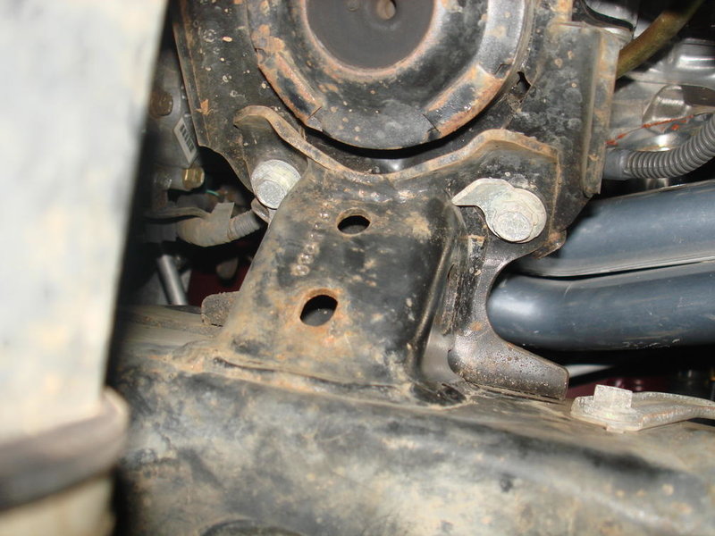

    HILOTOY
    HILOTOY HILOTOY
    Oct 10, 2008
    #9873
    479
    From Big Island
    05 trd 4wd off road,tow pack
    couple pics of mine.........still solid:rolleyes:

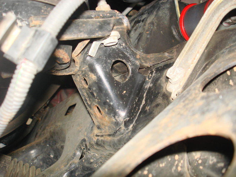

    New member here. Googled y'all up under failed engine mounts and glad I did. Just took my 2005 Tacoma to a local shop to have motor mounts replaced due to fan hitting housing. Found the identical failure depicted earlier in this thread. Local Toyota dealer said, of course, that no one's ever heard of such a problem. His regional(?) rep is to be in the area tomorrow and I'm invited to bring my truck in for him to look at. For your record keeping, this truck has never had any sort of modifications made to it and has only about 45,000 miles to it's credit. It gets used for work off-road about three months out of the year. It's used hard, which is why I buy Toyotas, no? But it's never been abused. Frame just broke.

    That'll be a tough sell. Your best bet is to find a local fabricator or skilled welder that will fix the issue. Dealers aren't really equipped for this kind of repair.
    You'll want to make sure that the mount is shifted back to the original position before any reinforcements are welded in place.
