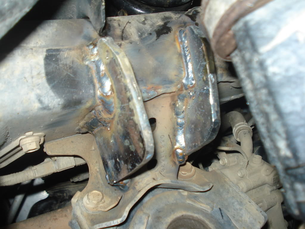

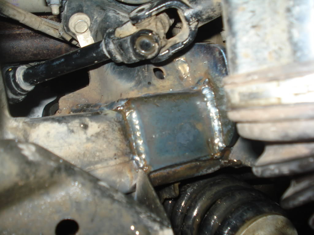

    Got mine popped back out and welded up soon after I posted around christmas. Been on a few trails and put some serrious load in the bed, no issues now. Love this damn truck!!!!!! Time for some real love (new tires, upgraded brakes, tow kit, shocks, paint, axle seal, rear locker, etc)

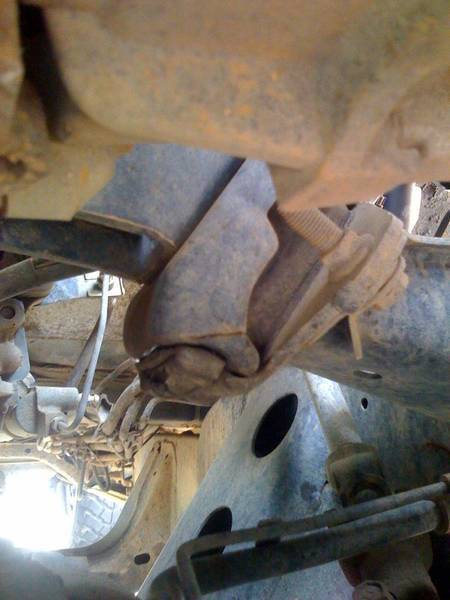

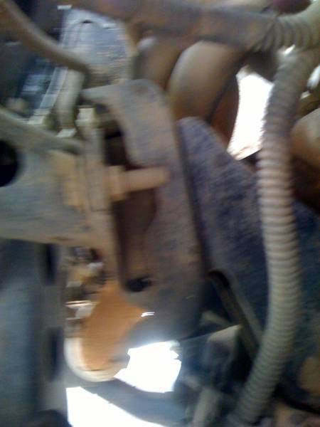

    Anyone ever seen this ?
    Here is the passenger side for reference
