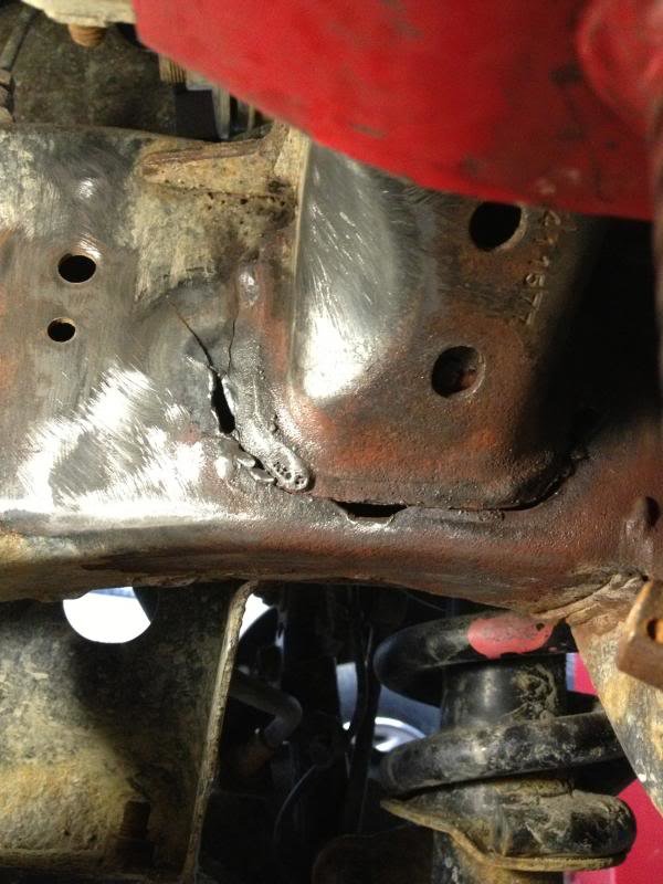

    These are photos from in the middle of the fix, while the truck was up on the lift. He had heated the frame, pounded it out to get it back in somewhere near the right shape, and of course had hoisted the engine up out of the caved in frame.
    Another of the front driver side mount in mid-fix:
    This one is of the passenger side mount prior to clean up and gusseting:

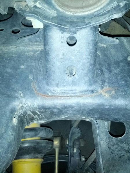

    Just noticed my passenger side has failed on the bottom of my 05

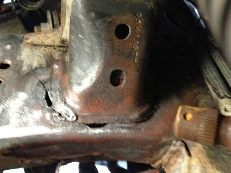

    So i have an early 06' model tacoma and i reciently had my motor mount bracket/frame fail identically to alot of the others on this and other forms. the driver side mount caved in about 3/16" where it meets the frame. there was a small amout of rust around the break so i know it had been fractrued earlier on and finally gave away. the passenger side is slightly indented and also has started to crack with a bit of rust ( not fully broken yet).
    After a decent sized bump. The fan started to hit on the shroud letting me know i had a problem, i took it to a local shop and they said i needed to replace the bolt on motor mounts. i got on line and researched failed motor mounts on 06 tacoma and ran in to this forum. ( can i say life saver) i got under the truck the next day to find that it was not the motor mounts but the mount bracket where it hooks in to the frame.
