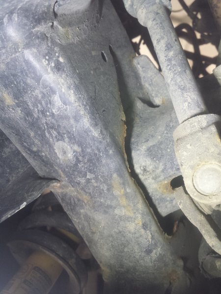

    I'm adding my '05 v6 pre runner access cab automatic. driver's side. Heard noise in the engine bay when I put it in reverse, and it turned out to be the fan hitting the shroud. Looked at it, and it seemed off center. Remembered there was this thing about bad frames, and checked the mounts. Sure enough, the drivers side caved in. Maybe my insurance will do something? Wouldnt mind getting cashed out...

    After a day at the dunes, I come back and notice that my (6 speed) shifter was sitting way to the left, so 3rd and 4th look like they're in 1st and 2nd. Upon deep inspection I find my driver's side engine mount is caved in, and the break is actually quite rusty, so it was probably broken for a year. I noticed that the shifter tended to oscillate back and firth on rough terrain and hard acceleration on sand, ever since I bought the truck a year ago. So this is probably the cause.
    It makes a groaning noise in reverse, and also sounds like my tures are rubbing whenever I turn, but those might be unrelated.
    I will see about getting Toyota involved, but even if they do anything, the repair might be another band-aid. Since I have a shop and welder, I'll probably just end up doing it myself.
    I knew I shouldn't have bought a truck so young in the generation...

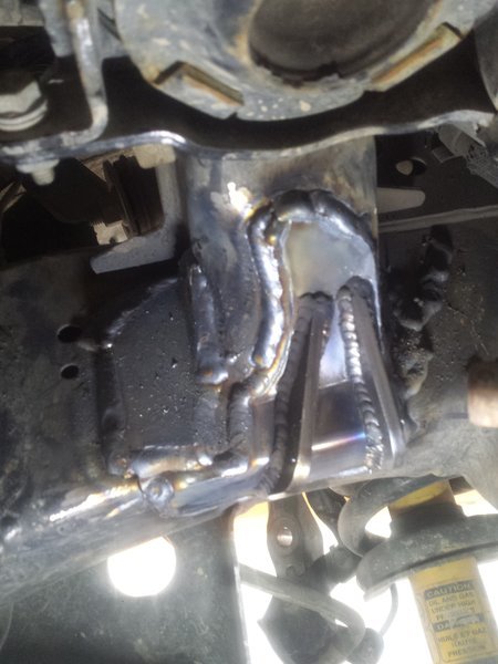

    One weekend in my shop, and it's fixed. Tim at DMZ fab was very helpful in providing tips and advice on proceeding with the repair. My local dealer said they have never ran into this problem before...I call BS, and didn't even bother bringing it in, because I knew what the outcome would be. Took matters into my own hands, and now I don't have to worry about it failing ever again.
