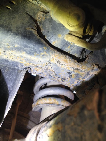

    So the 05-06 Tacomas are breaking frames at the drivers side engine perch for the mount. Did one yesterday and its not an easy job. Here are some before and after of the drivers side.
    Before, over 1/2" pushed in and frame completely torn!

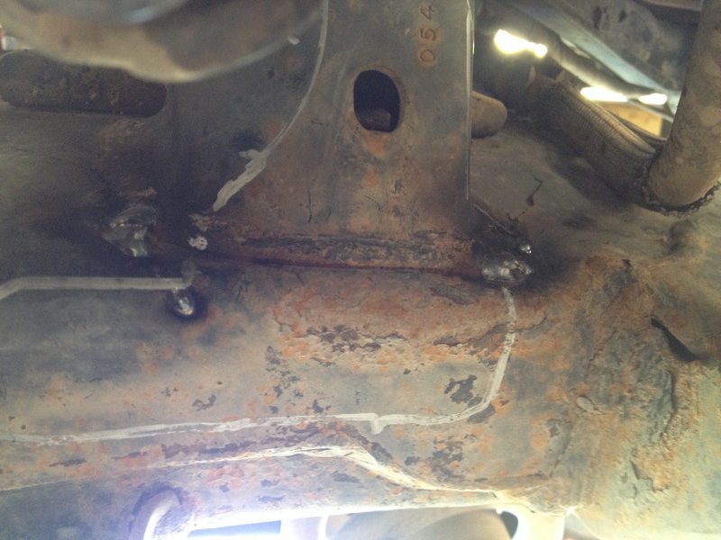

    Tac welded it after pulling it out..

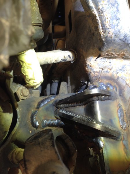

    After gusset and final welding.
    Not much space in there I must say.

    what do you recommend to reinforce? I have an 06 prerunner that I like to take on trails

    DMZ fab makes a great set, thats what I used in the pic. its 2 pieces for drivers side and 1 for passenger. Should make it very strong as this one was really bad since the mount was almost ripped completely off.

    I had the same concern. Best is to get up in there and see which pic it looks like from post #11. Then you'll know for sure.

    Was changing the oil the other day and noticed the passenger side weld under the motor mount is starting to separate. It’s cracked about 1” out of maybe 6” of welded surface.
