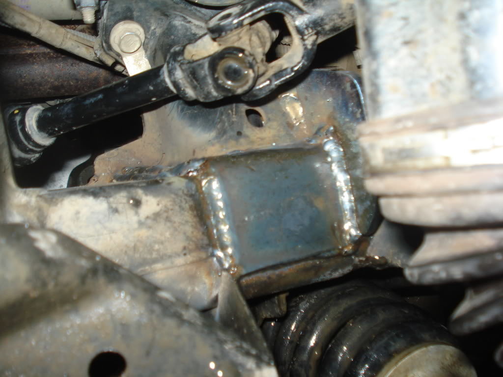

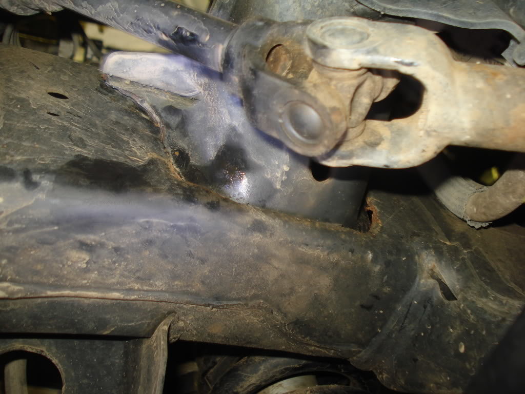

    You mean the gussets im going to use to put the mount back up? Basically it will look similar to the work that Marnes on TTORA had done to his 05 Taco. Ill post the pics on here because Im sure he wont mind since he post them on TTORA a few times. Im not saying mine are going to look exactly the same because different people do different work, mine might not be as good as his or they might be better i wont know till i see it but here are the pics:
    In the picture you can see a gusset in between where it was mounted to the frame and there are also vertical gussets in there which help it from wanting to cave into the frame. He is going to fix the drivers side on mine, which caved in all the way, and he is going to patch the passengers side and put the vertical gussets on it to keep it from doing that, as well as fix a cracked weld. Here is the pics of my drivers side before:

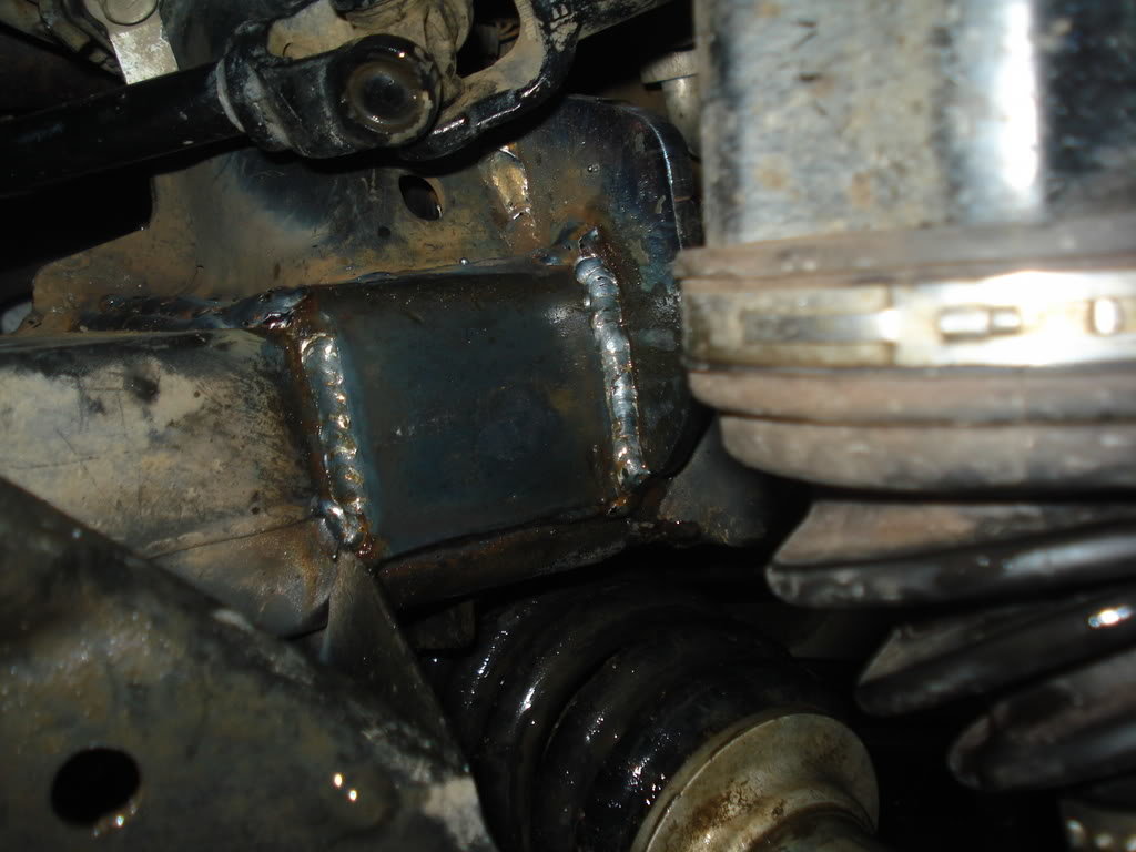

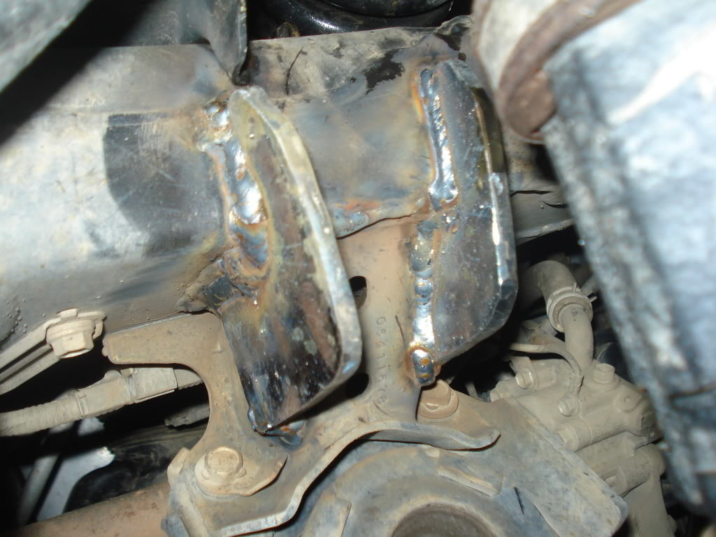

    Alright here is the finished product! I think he did a pretty badass job myself, he didnt pull the motor and did it on a lift and he jacked up the engine with a tranny jack (a stand one) All I have to do it spray some Rustoleum on it tomorrow when I have a chance. Its too damn wet out right now, we have a lot of snow and had a 46 degree day and everythign is melting pretty good. Anyways I will post the pics here. First one is the Drivers side and the second is the passenger side. Oh yeah and guess what he charged me......I know its an OUTRAGEOUS amount....$250 bucks:
    Drivers Side:
    Passengers Side:
