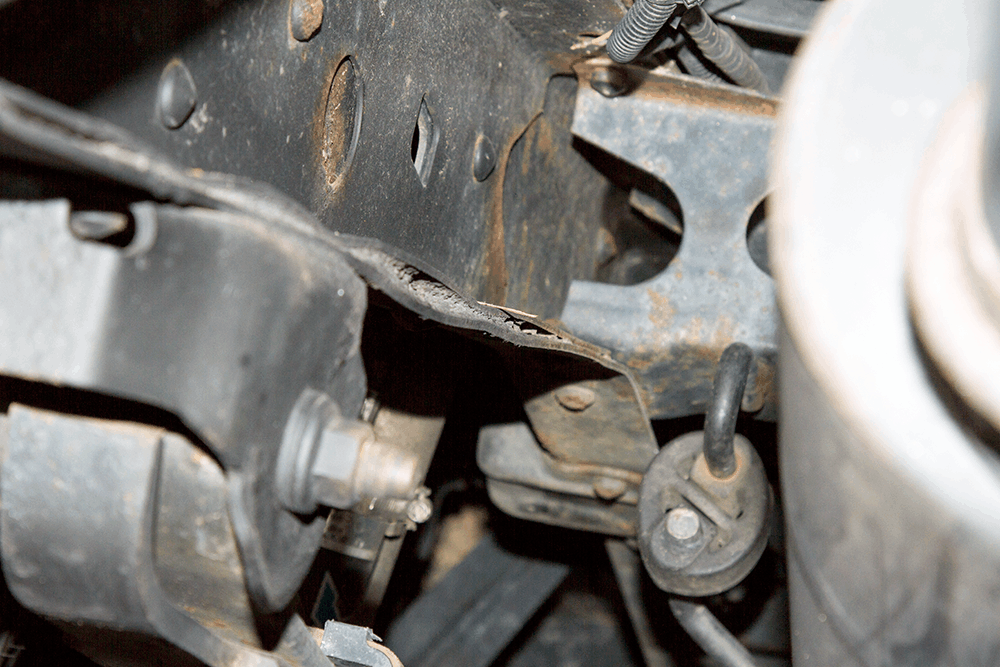

    State: Va
    Year of production: 2006
    Exact model of truck: AC Sport
    Status of Toyota inspection: Inspected by dealer. Toyota told me to shove it and buy a new truck with a $750 credit. Complaints filed with BBB, NHTSA, and tried media. Truck traded in on a Ford
    Picture of frame perforation

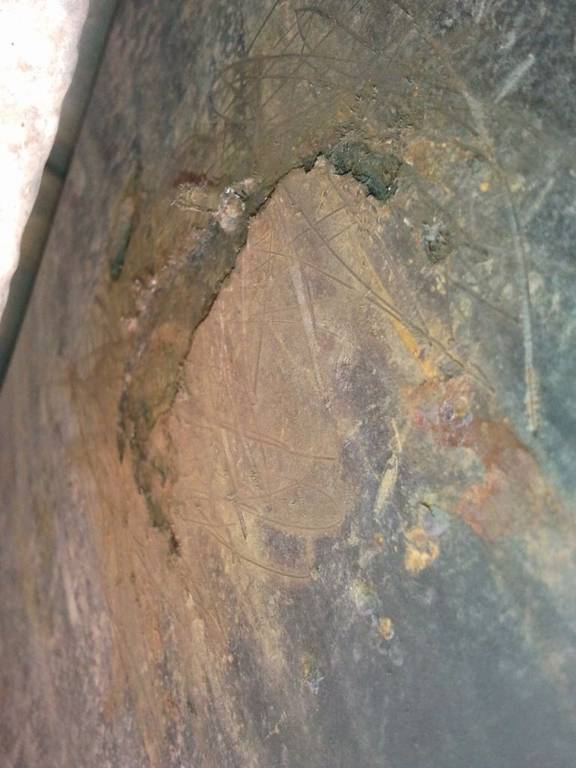

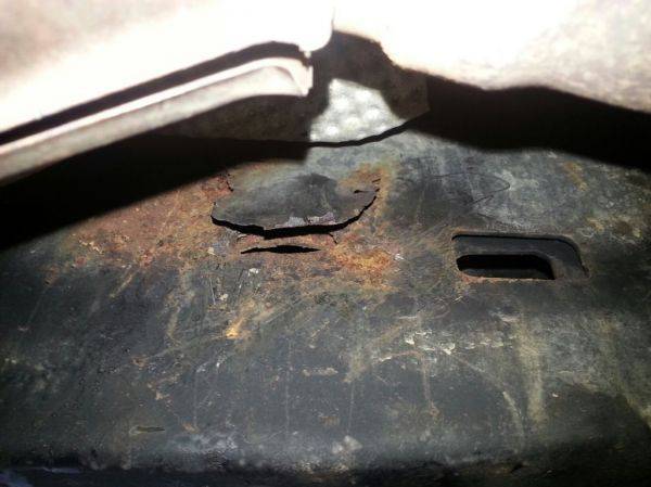

  4. Oct 30, 2013 at 5:12 PM
    ruggedT
    ruggedT The Sticker Guy
    Jun 24, 2011
    #58788
    3,177
    Stan
    Midlothian, Va
    2016 Ford F250
    Diesel on 35's
    Added a 3rd pic up there... noticed the frame separation today.

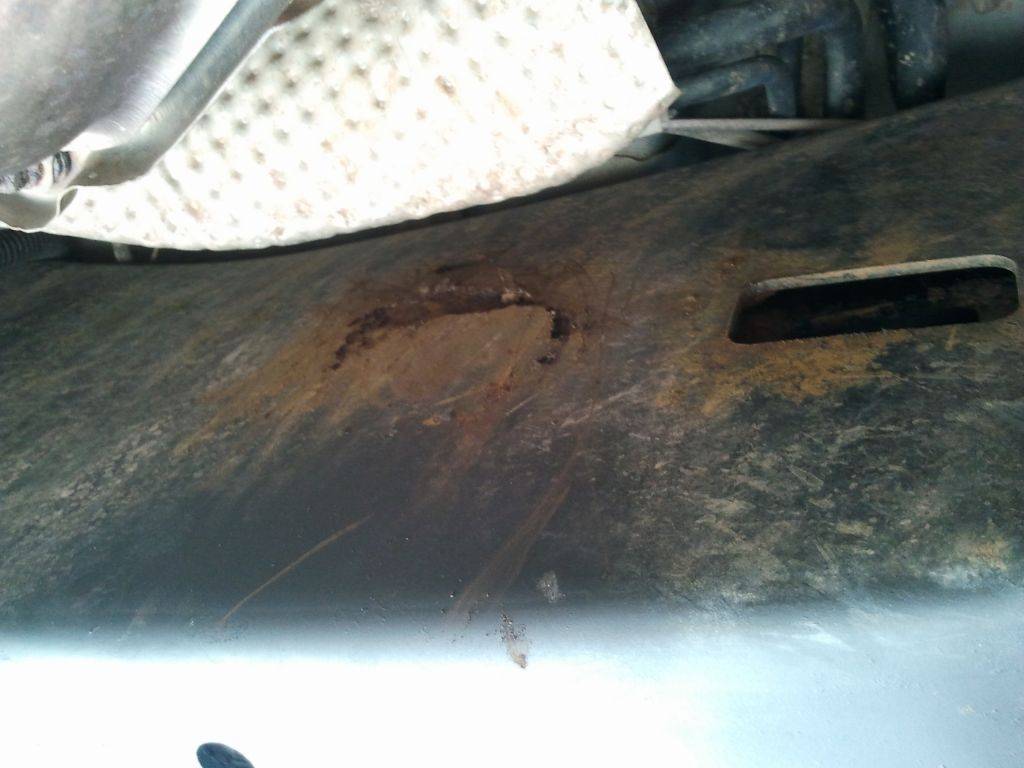

  5. Nov 2, 2013 at 3:05 PM
    CorrosiveTendency
    CorrosiveTendency When up to your nose in shit, keep your mouth shut
    Sep 29, 2010
    #43987
    2,188
    Nathan S.
    Schuylkill Co, Pa
    05' DblCab SB Speedway Blue
    OME 885's, Locker Mod. Bilstein 5100's on 4 corners
    [​IMG]2005 Double cab short bed. To be inspected. Same place as above pic.

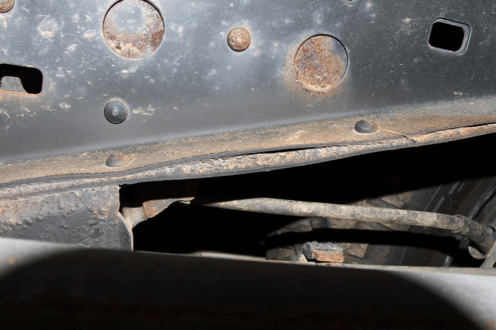

  6. Nov 2, 2013 at 3:17 PM
    tacomeontherange
    tacomeontherange this ain't no picnic
    Jul 20, 2011
    #60216
    148
    central KY
    05 SR5 tacoma TRD
    large hole in frame

    @ RuggedT , in your first pic , is that area up front ?
  15. Nov 8, 2013 at 8:30 PM
    ruggedT
    Jun 24, 2011
    #58788
    3,177
    Stan
    Midlothian, Va
    2016 Ford F250
    Diesel on 35's
    Yes, just behind the cat on the inside of the frame. Drivers side
