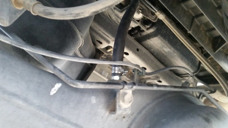

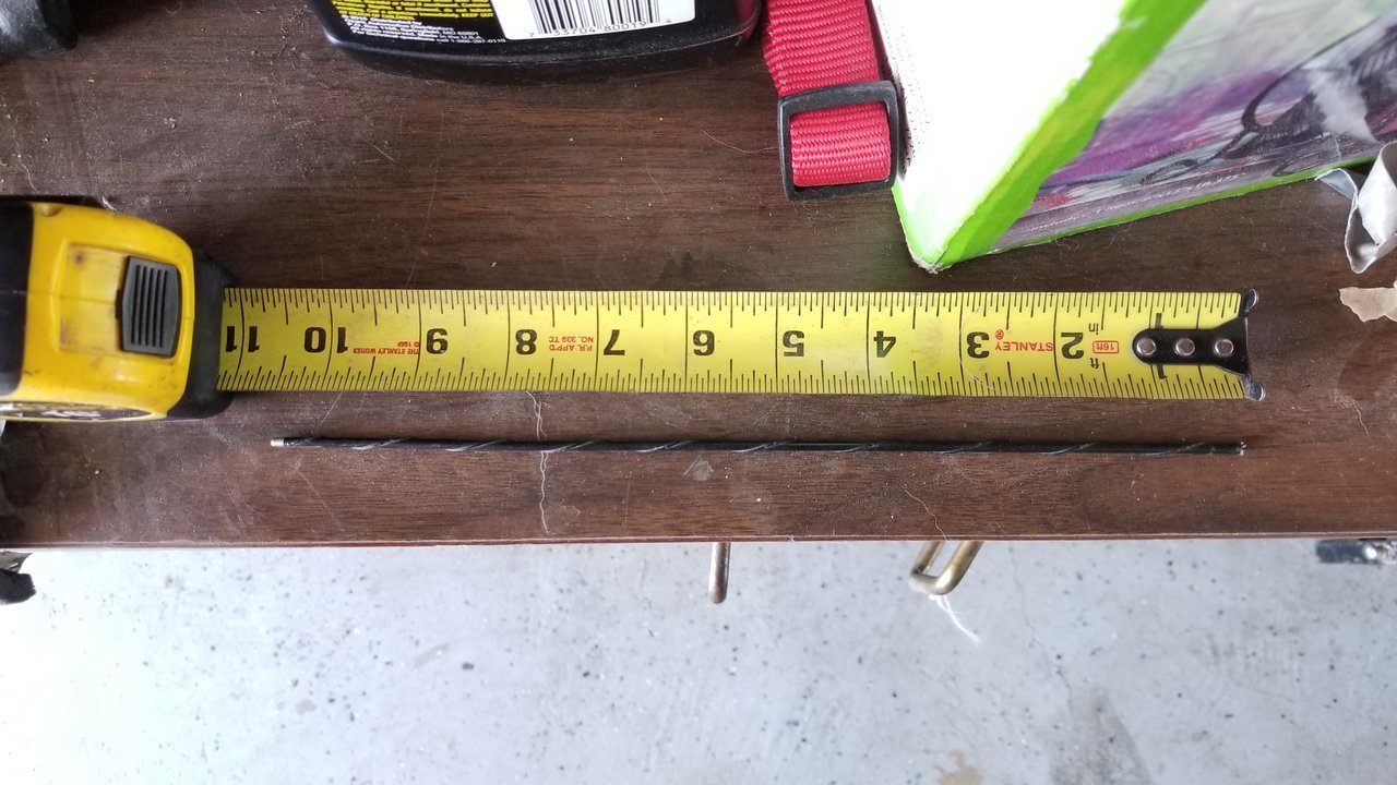

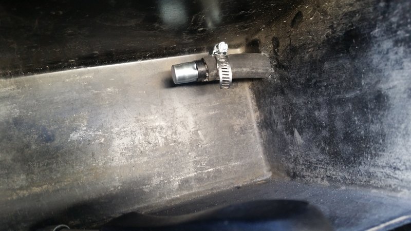

    Thank you to @David K for the thorough write up. I followed it step by step to complete my differential breather mod.
    Here's a link to his post.
    https://www.tacomaworld.com/threads/my-differential-breather-mod-photos.111954/
    Here's my outcome
    To figure out how much slack I needed I ended up running the hose and lifting my rear end by the tow hitch. What everyone else has said is about right. I bought six feet of hose and cut off about one foot once done.
    MarX, David K and eccracer104 like this.

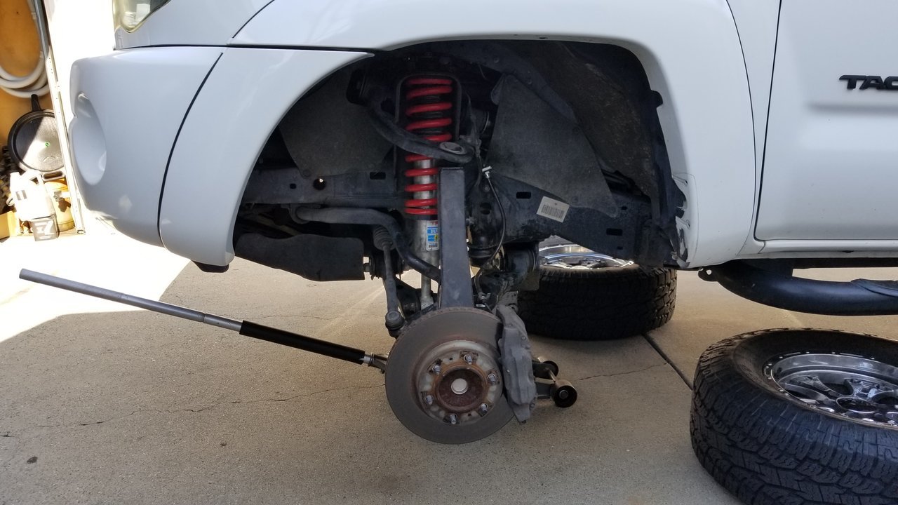

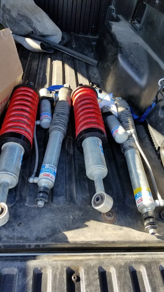

  8. Jul 1, 2017 at 8:36 AM
    #28
    LOLLY
    LOLLY [OP] Well-Known Member
    Oct 11, 2016
    #199547
    834
    Alfredo
    Norwalk, CA
    '05 Tacoma DCLB TRD Sport (RIP) Now '21 TRD Off-Road

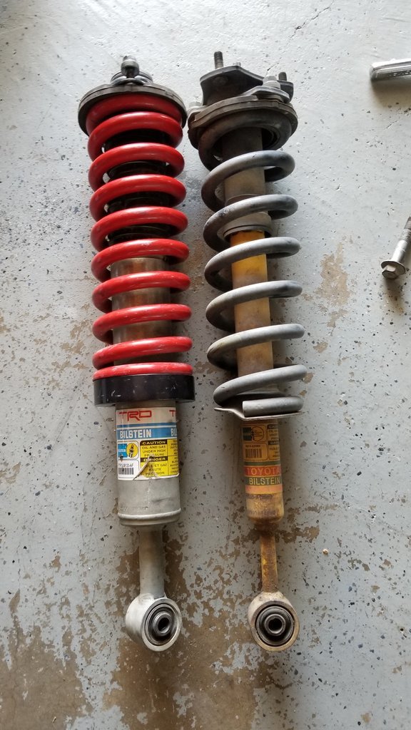

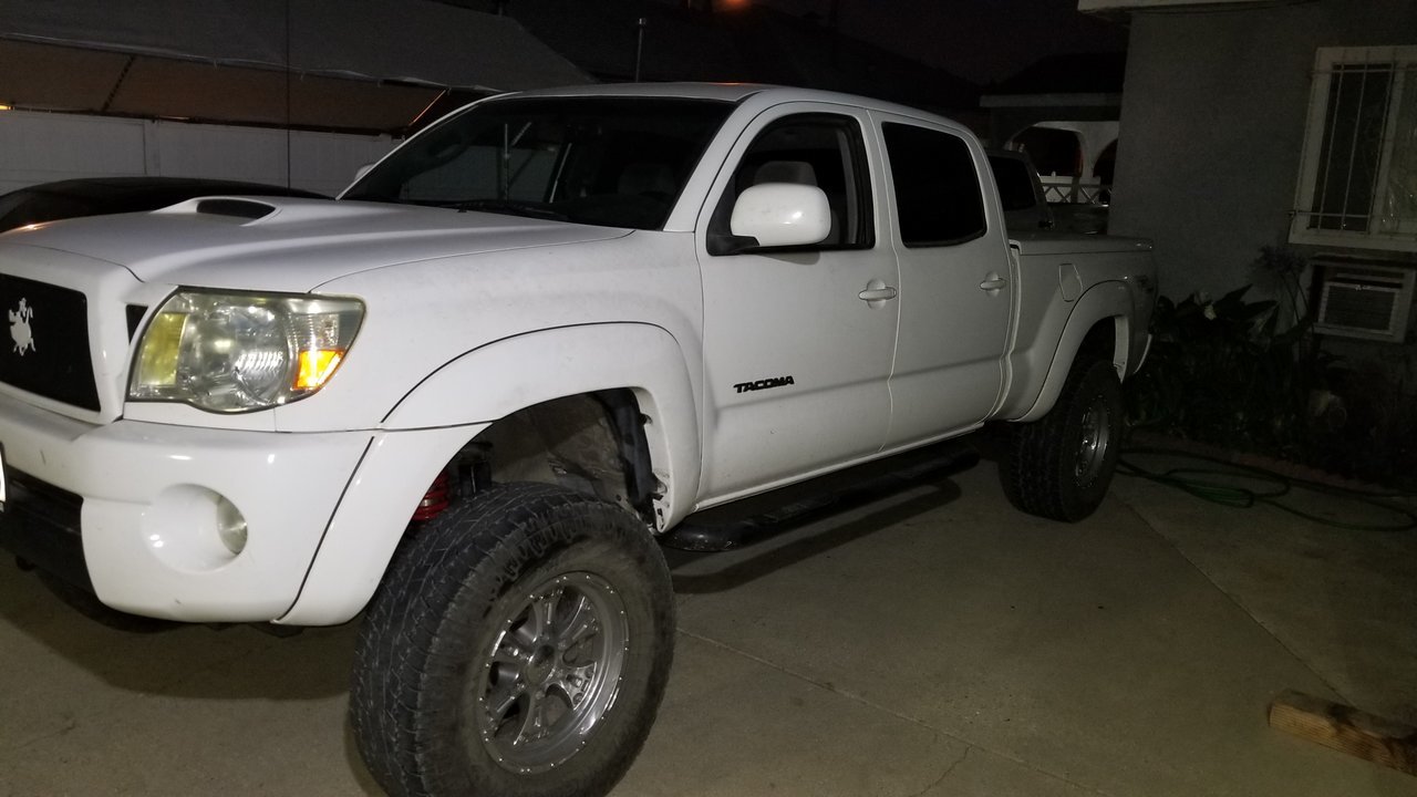

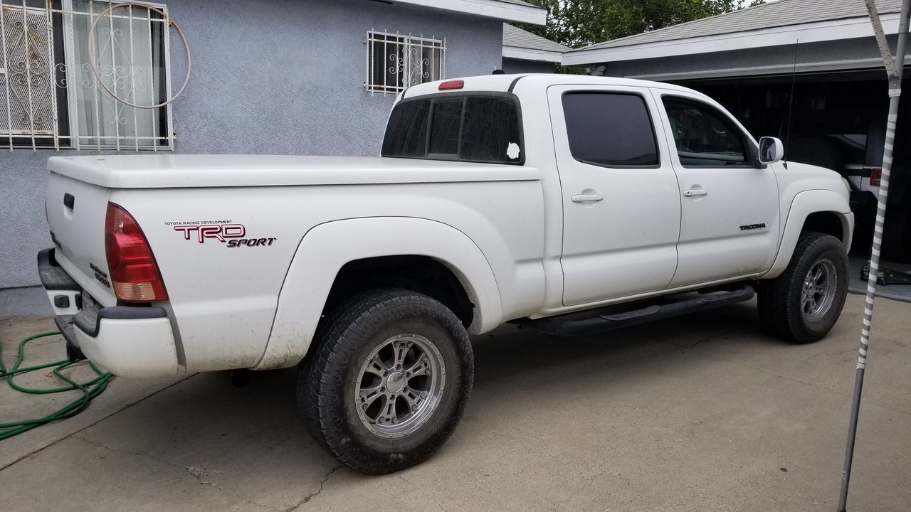

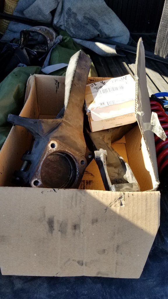

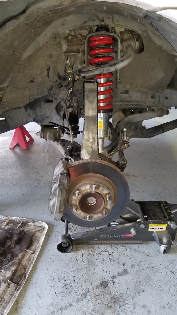

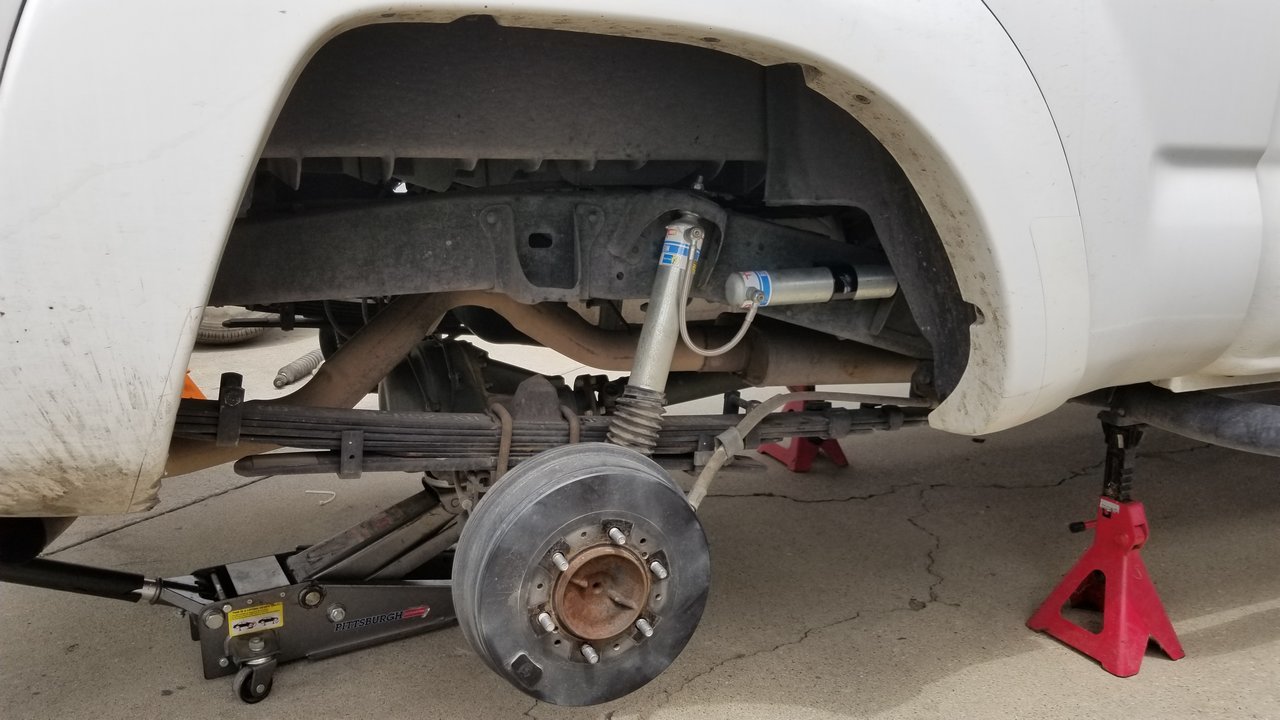

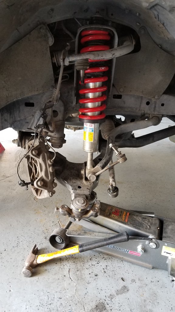

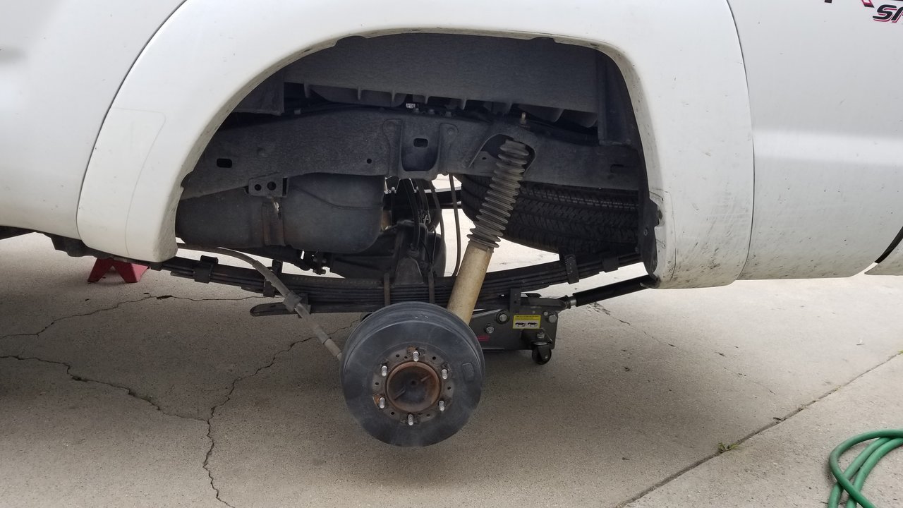

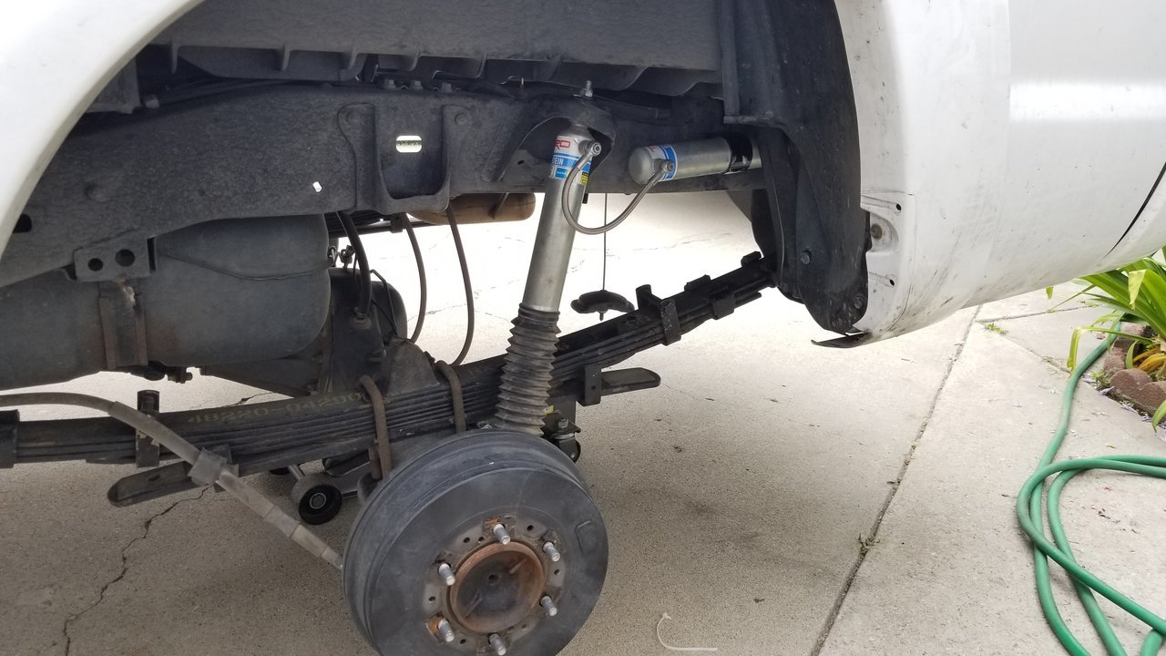

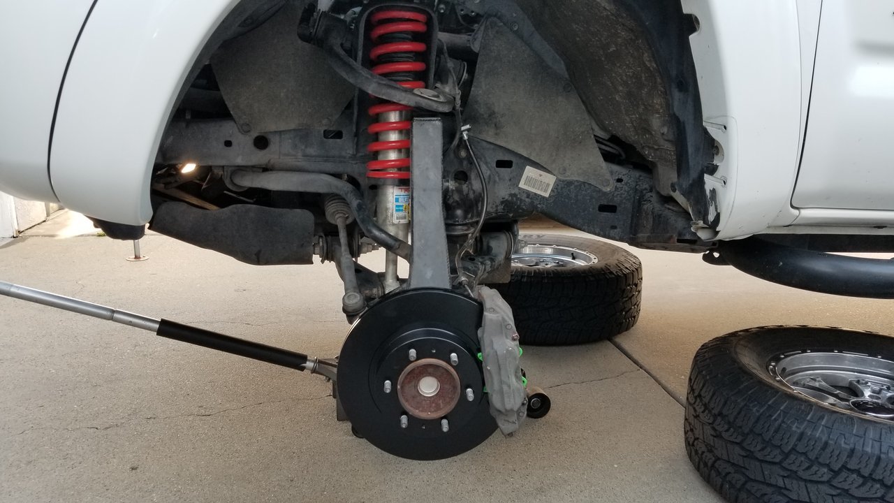

    Yesterday was a loooong day. From sun up to sundown.
    Before
    Let the magic begin
    I even had a side kick help me throughout the process
    Then back to work
    The front was where all the fun was at...
    And finally. The finished product
    The rear stayed the same at 24" from center hub to fender since I only changed the shocks. The front went from 23.5" to 27" with the new shocks, coils, and spindle lift.
    :benchpress::muscleflexing:

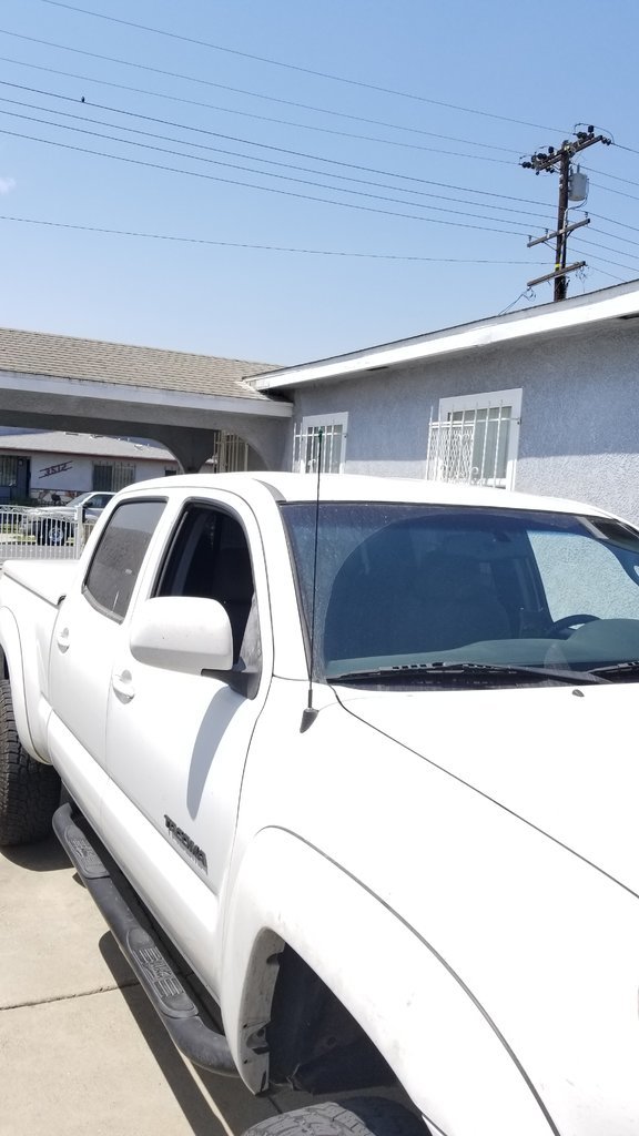

    I got tired of slamming my antenna in parking structures so I trimmed it flush with the roof of the truck.
    eccracer104 and MarX like this.

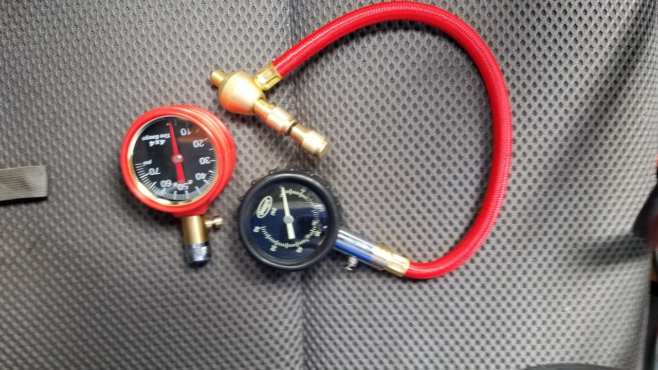

    I also updated the crappy gauge on my tire deflator.

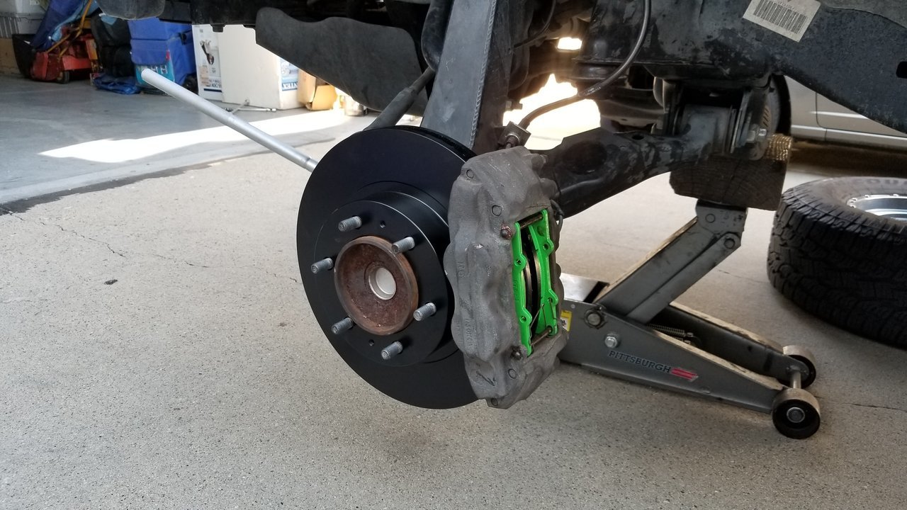

  14. Aug 28, 2017 at 9:04 PM
    #34
    LOLLY
    Oct 11, 2016
    #199547
    834
    Alfredo
    Norwalk, CA

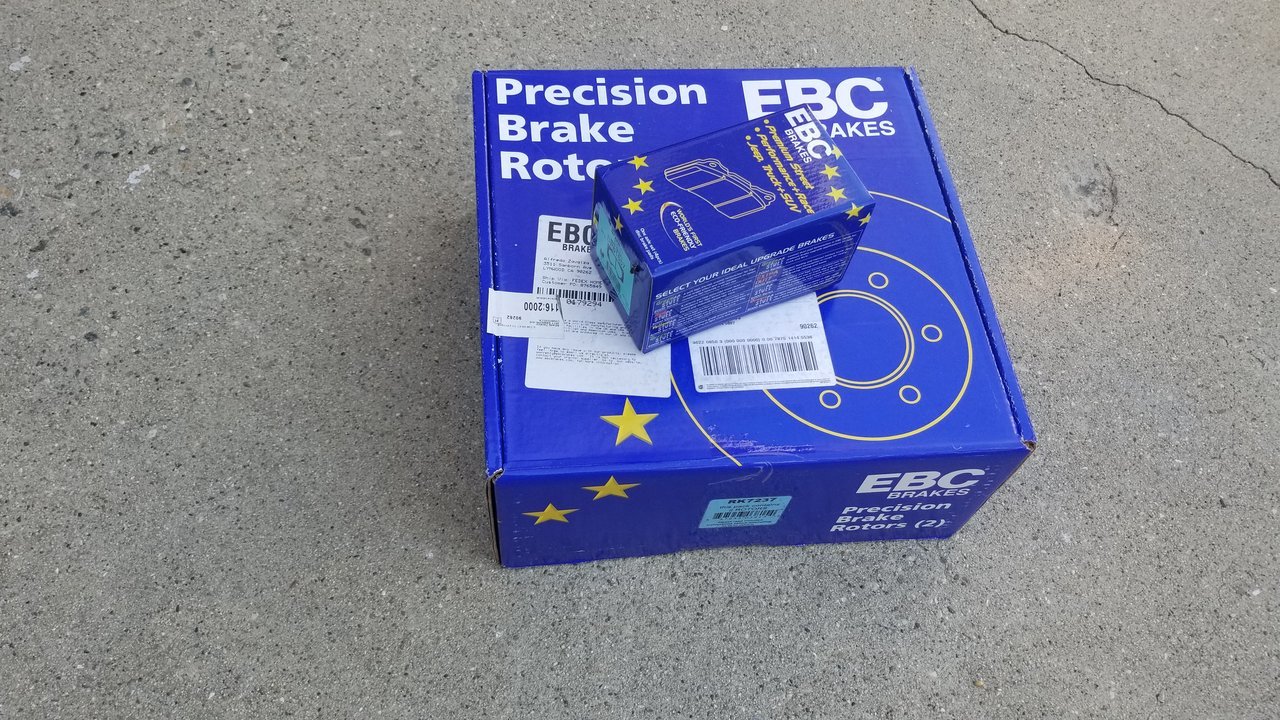

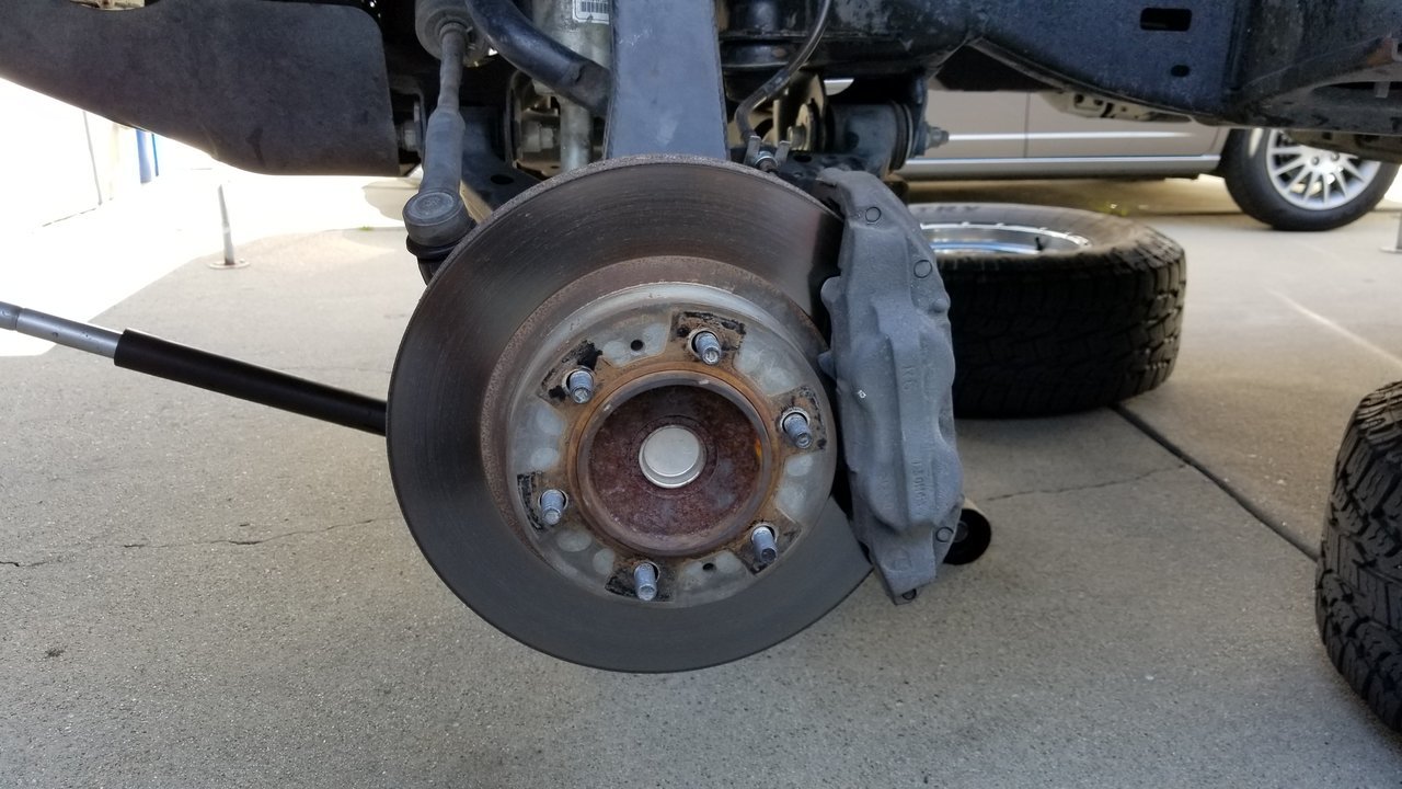

    Huge thank you to @eccracer104!!!
    This weekend was a pretty lucky weekend for me. Right before heading out to New Orleans mid last week I noticed that my brake pads were thin and rotors needed to be resurfaced. I was freaking out because I leave for the Mojave Trail this coming Saturday. I hit up @eccracer104 And he took care of me! New pads and rotors were at my parents house before I even got back to Cali. Next thing you know that storm starts brewing in Texas. I was able to get a flight back home right before the storm. As soon as my plane lands, I shoot over to my parents house and sure enough...
    Out with the old
    And in with the new
    I should have the pads seated and ready to go by Saturday
    :burnrubber:
    itaro and eccracer104 like this.
  15. Aug 28, 2017 at 9:54 PM
    #35
    eccracer104
    eccracer104 O.G. Member
    Apr 9, 2008
    #5854
    14,170
    San Diego, CA
    2016 Tundra 4x4
    Mmmmm those look good! Hell yeah man! :woot:
    The anti-vibration shims EBC uses are cool too. Super easy to put in.
    Take the first ~100 miles easy on the brakes and they'll be solid! :cheers:
    LOLLY[QUOTED][OP] likes this.

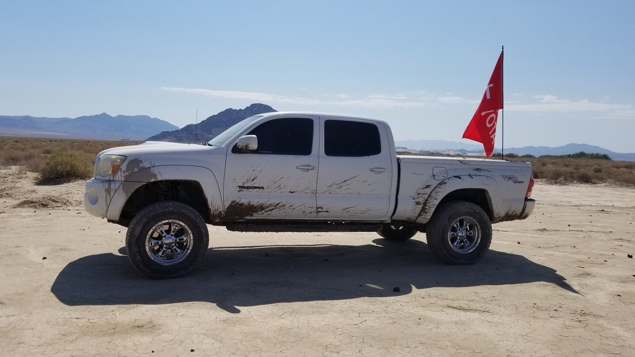

    The trip started off with one f150, one Cherokee, two 2nd gen tacos and one 3rd gen taco. Everyone 4wd except for me. Hotter than hell but thankfully the A/C worked without a glitch!FB_IMG_1504659590726.jpg 20170902_083936.jpg 20170902_101723.jpg 20170902_084824.jpg 20170902_102852.jpg
    Soda lake was dry for the most part but mud pockets were hiding under the dust. Not enough to cause damage but just enough to get everything dirty. 20170902_104630.jpg
    Right after soda lake, the jeep said he was over heating. My brother I the f150 went back to check on him. He got a little carried away on the way to the jeep and blue a tire.
    The rest of us waited ahead while my brother changed his tire and the jeep cooled down a bit. Meanwhile my new buddy from northern Cali started playing around. 20170902_113548.jpg 20170902_113602.jpg 20170902_113619.jpg
    The lava tubes was a sight to see! It turns out there was a lady in there doing a nude photo shoot right as we were walking in. I didn't get to witness anything since I walked in last. All I saw was glitter sprinkled around. 20170902_132256.jpg
    At this point the jeep said he didn't think it was a good idea to continue. He said his goodbyes and headed home with his tail tucked between his legs.
    Somewhere along the lines there was one rutted hill that my 2wd required a tug. Everything else went through with ease.
