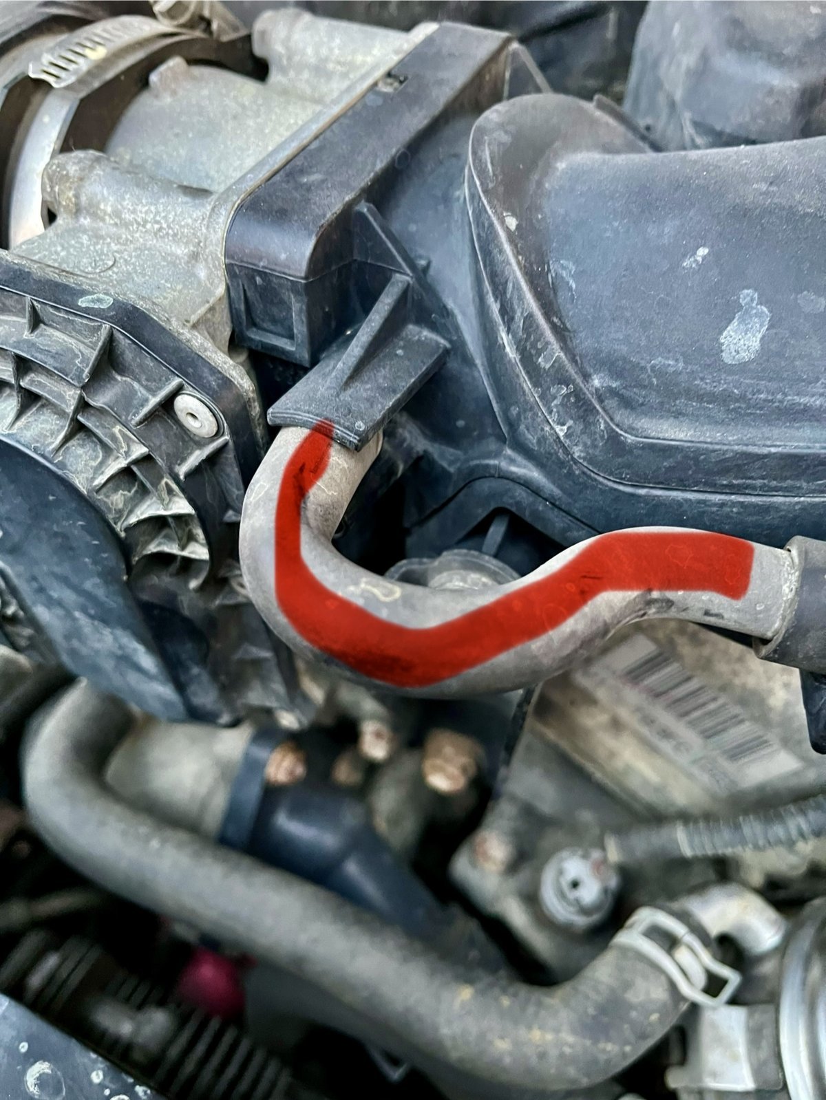

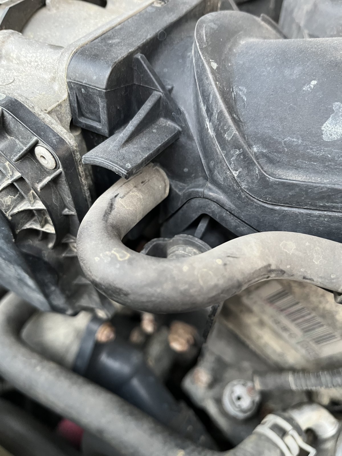

    Finally finally changing oil filter i knock off this hose IMG_0080.jpg IMG_0079.jpg
