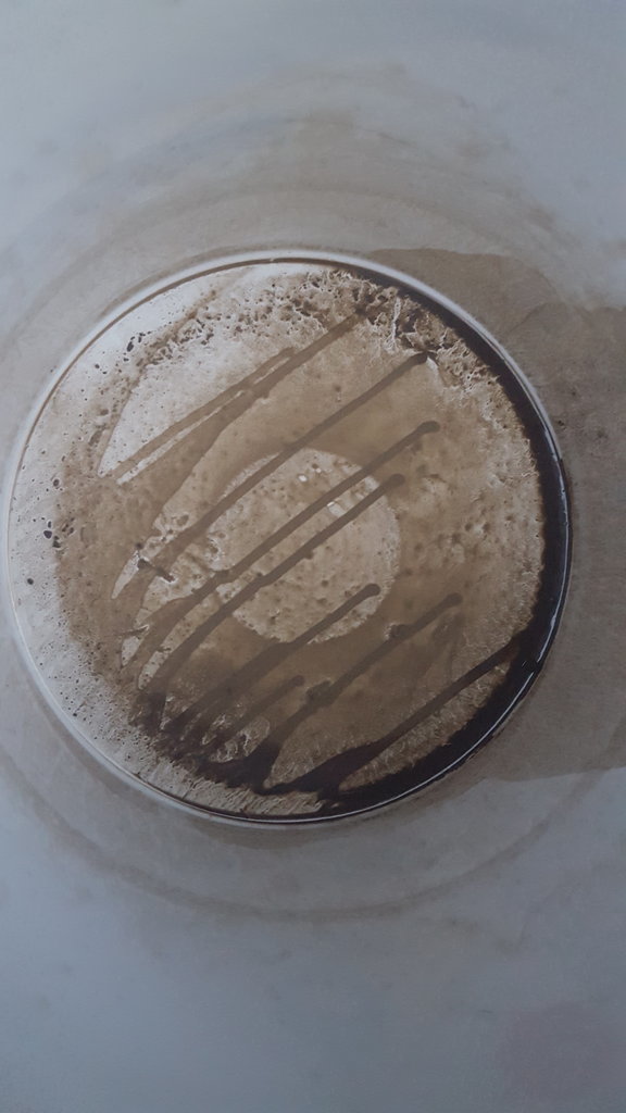

    Oh no. That was a recommendation to do so. Your intank filter is beyond saturated with contaminants.
    Like this crap....
