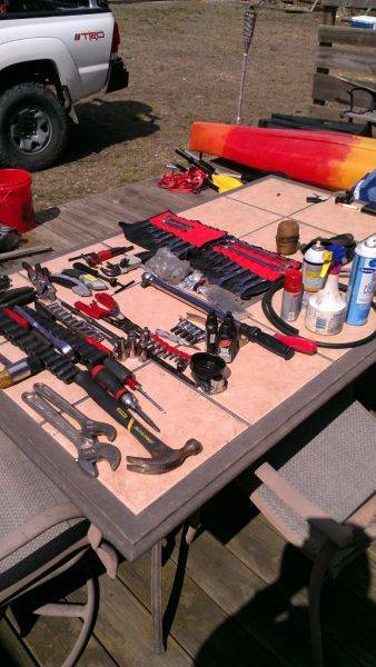

    Some of the pics are old & some are from today.
    It's a ladder rack with 800# limit. I have had hundreds of pounds of aluminum extrusions on it + my tool box is heavy as hell.
    Here's just one of my tool bags from my tool box. I'm guessing at least 50#.
    I'm sure by now your bedrails are rusted up for sure. Prob also crushed.
    I started the thread because I was getting a ton of PM's about it. I had originally done it a few years ago but I didn't take pics of it or have enough caulk to finish. Today I stripped the bed for other reasons and decided to finish it up.
