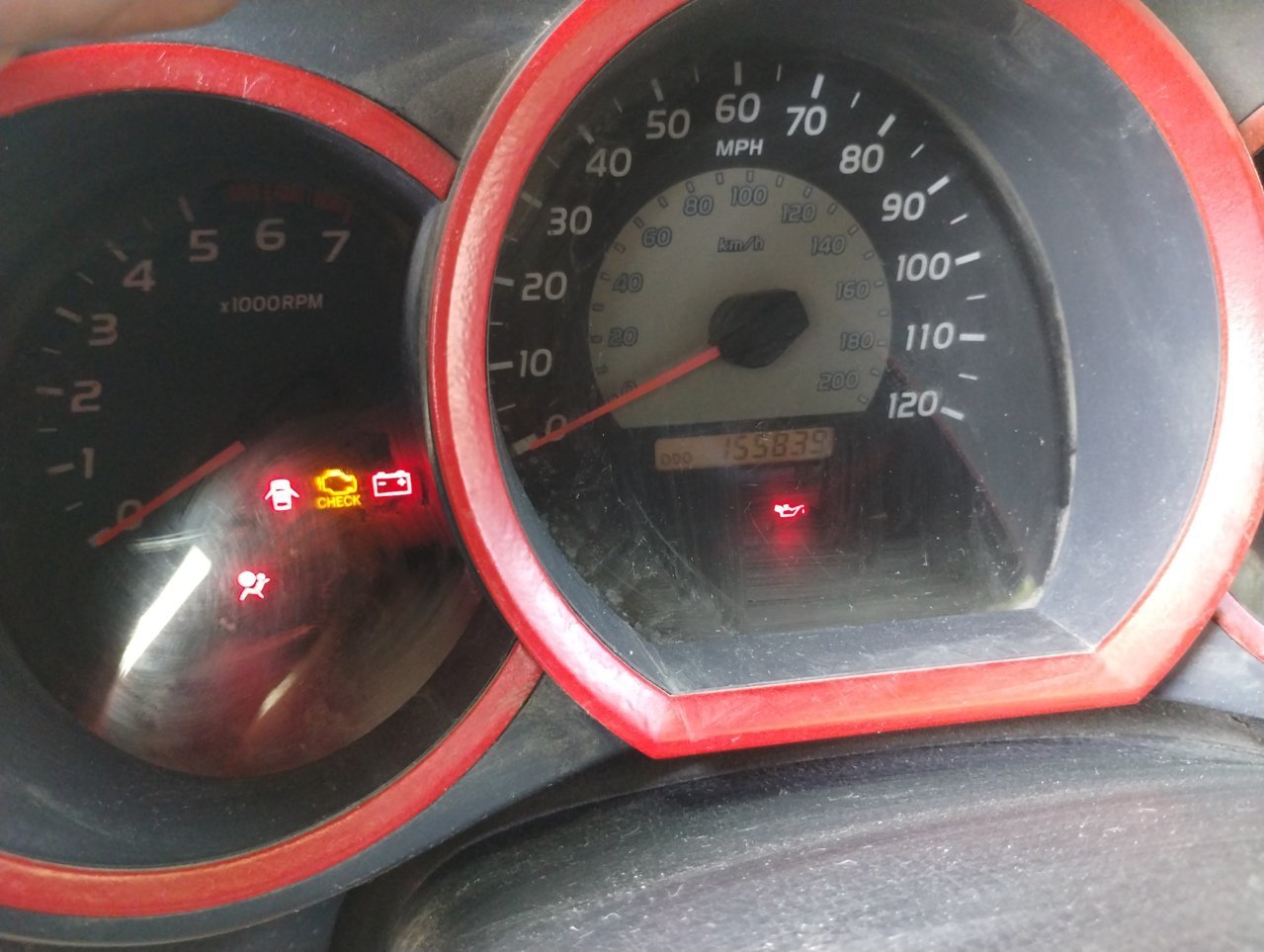

    Pin 9 has power now. But it's fluctuating due to crap battery. Cel is on continually now

    Lights are on

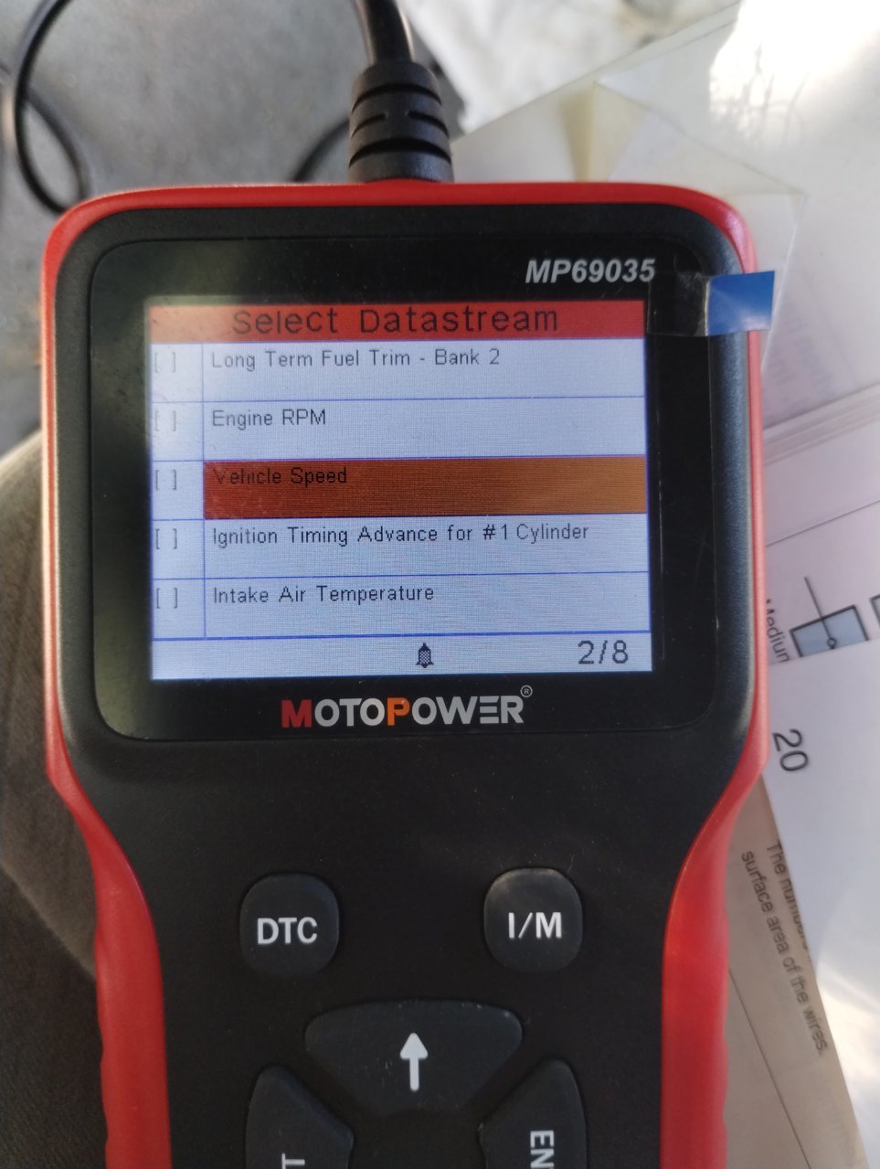

    And scanner is working now. I'm going to get a new battery

    You wanted rpm?

    Yea I was trying to verify the PCM was at least seeing a crank signal, you should see around 150 RPM cranking.
