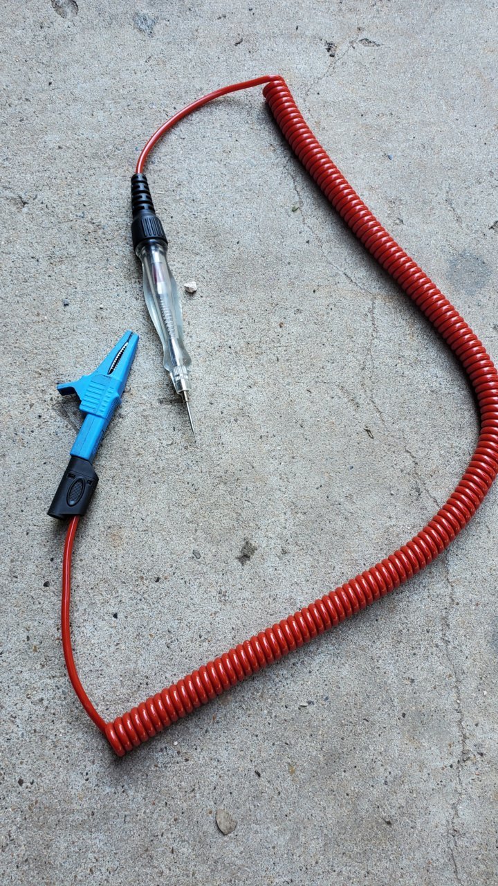

    banana jacks?

    I just cut the crappy ground clamp off and replaced it with a bananna jack, I usally keep a clamp on it but if I want I can put a backprobe or other test lead on it.

    ah thats how your using it. that makes so much more sense. you can back probe a connector and then touch the light to ground instead of having it clamped on a ground and doing it the way ive been doing it

    Yea I also often use it with this for interior testing where known good power and ground aren't always conveniently available.
    Power Probe - Cigarette Power Port Adapter (PPTK0026) https://www.amazon.com/dp/B07V9ZDKHB

    Yea it's meant for use with a Power Probe, mine came in my Power Probe kit. I rarely use the Power Probe itself but I use the cigarette adapter quite often for convenient power and ground when testing.
