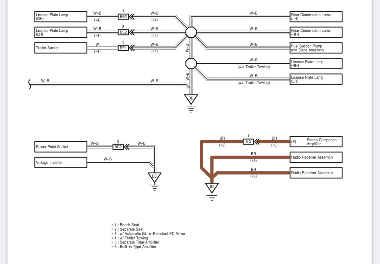

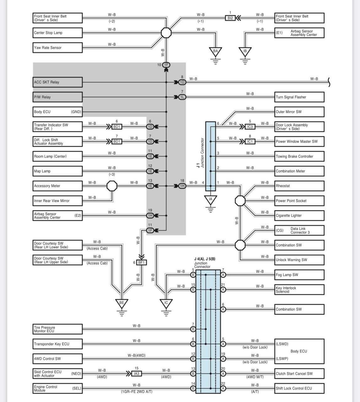

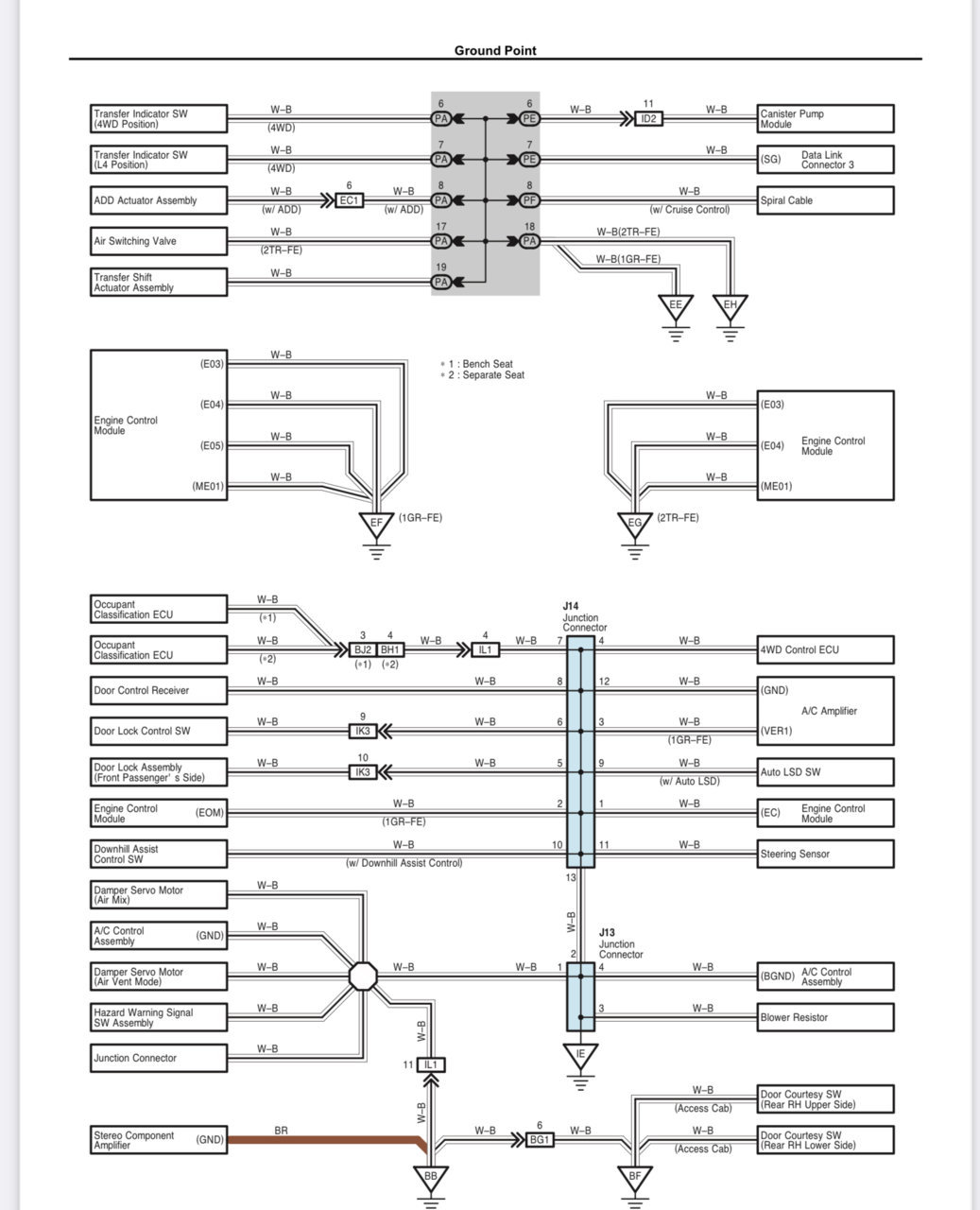

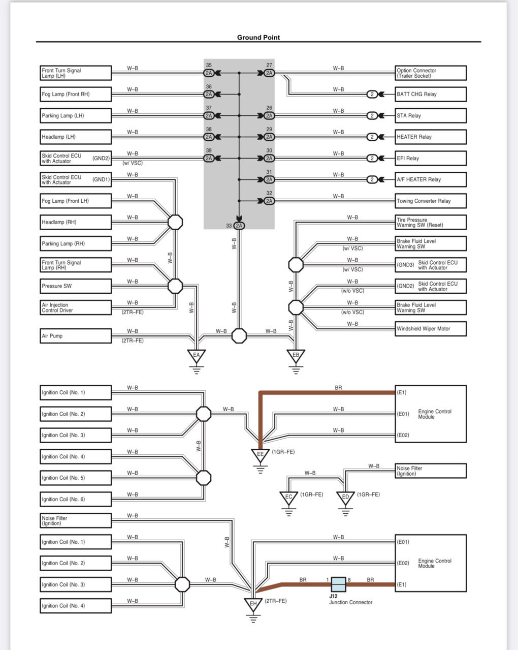

    There’s a bunch……
    If you know how to read a diagram and ground chart, you can sometimes get luckyif other things don’t work. Like the blower motor…..
    But that doesn’t always work. The ground could be broken at a splice or wire broken all together.
    I’ll add a ground point chart. You can try other things tied to those grounds and see if they are working.
    If you find all the things on one ground point not working, your diag just got easier.
    There’s multiple ways to diag electrical. I prefer to start with the common that are linked to each other.
    Don’t over think this, I’m just did the chart for reference. We really need to find the missing link at the ECU.
    Dm93 likes this.
  13. Jun 9, 2023 at 5:55 PM
    #53
    TnShooter
    TnShooter The TacomaWorld Stray
    Sep 2, 2010
    #42625
    21,360
    Deogee
    07' TRD Off-Road, Auto
    STOCK
    We need to check all these grounds.
    Dm93 likes this.

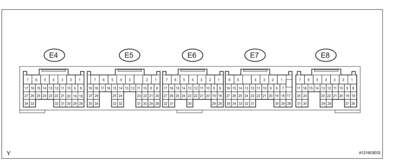

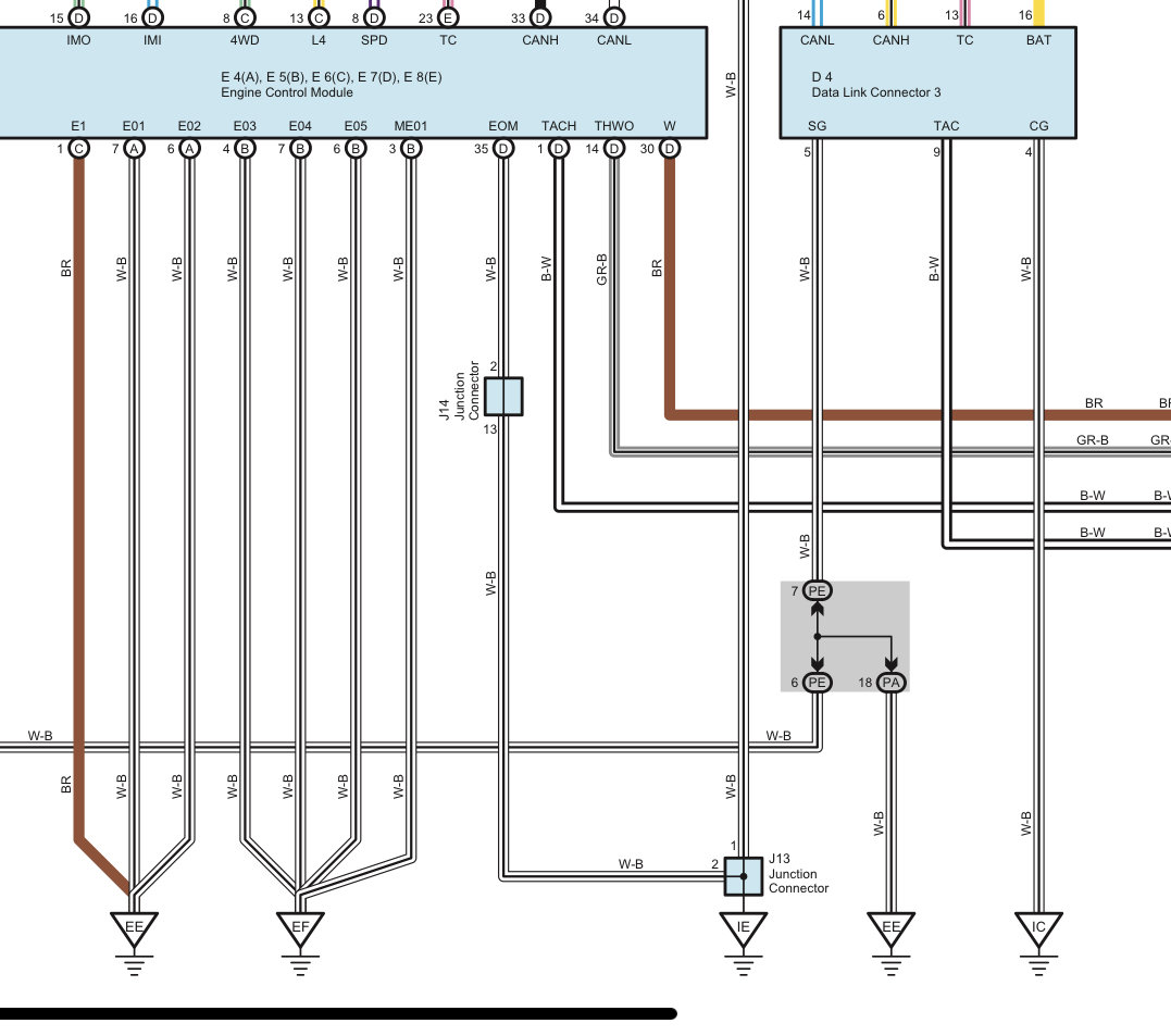

    @Dm93 can you provide the actual picture for the ECU with plugs labeled (I know you have it)
    Check the following for Ground
    Plug E4 - Pins 6 and 7
    Plug E5 - Pins 3, 4, 6, 7
    Plug E6 - Pins 1
    Plug E7 - Pin 35
  18. Jun 9, 2023 at 6:18 PM
    #58
    TnShooter
    Sep 2, 2010
    #42625
    21,360
    Deogee
    STOCK
    Great, then back probe the pins.
    Here is the ECU pinout.
    Just back probe the same pins I posted above.
    Dm93 likes this.
