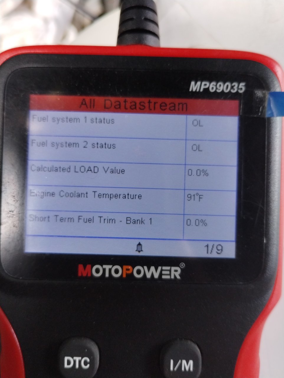

    No codes.

    That's what my scanner is saying. I feel like injectors are not injecting
