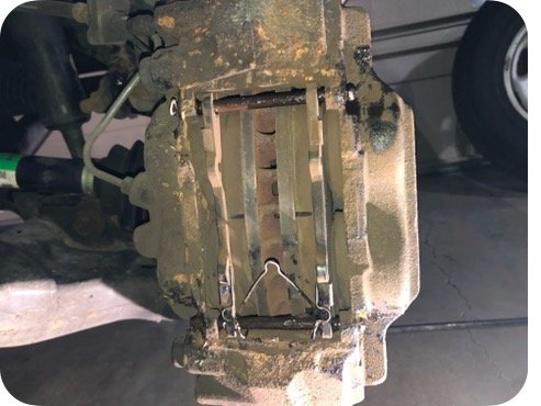

    That click/clack you're hearing when applying the brakes and changing direction is pad shift. Very common in the Tacoma. Nothing to worry about
    lynyrd3, 12TRDTacoma and Buildit[OP] like this.

    Ok thanks for the post. I had read countless posts in relation to brake noises. It’s kind of hard for me to compare sounds and vibration etc by reading. But I tried to verify when and how I heard it and compare that way.
    Putting grease on the caliper pins seemed to help some.

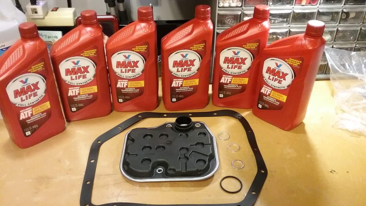

    I want to drop the Transmission pan and inspect/clean Inside and change the filter. Any suggestions on pan gasket brand? I see Auto Zone has 1 in stock near me it’s Duralast brand comes with a filter. I think a local Toyota dealer wanted me to use an RTV made by Toyota.

    I used a NAPA gasket and filter on my daughter's Yaris. Zero issues 12k miles later. I would say most of the OTC gaskets and filters are all about the same.

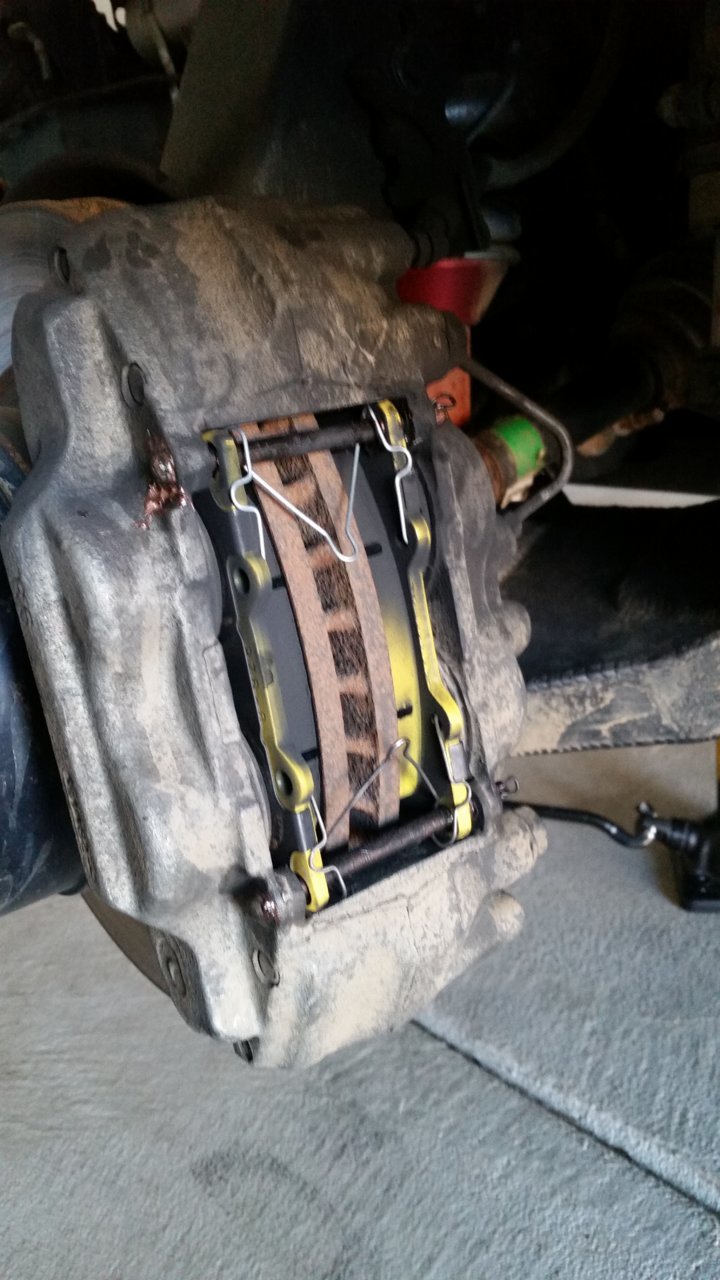

    Yes the Polyurethane carrier bearing is SO worth the extra work. It handles all of the power my 370HP pig throws out at it, and has been doing so for the past 4 years, so it could definitely handle whatever you got as well.
    Do yourself a favor and run a secondary brake pad retention spring. This isn't discussed enough, but it should be. I have never had a clacking issue after doing that a lubricating the pins ever since my first brake pad swap out.

    Ok that is awesome intel Sir, quick mod to help eliminate that annoying clacking noise. Putting the spring on both pins seems like a good idea.
