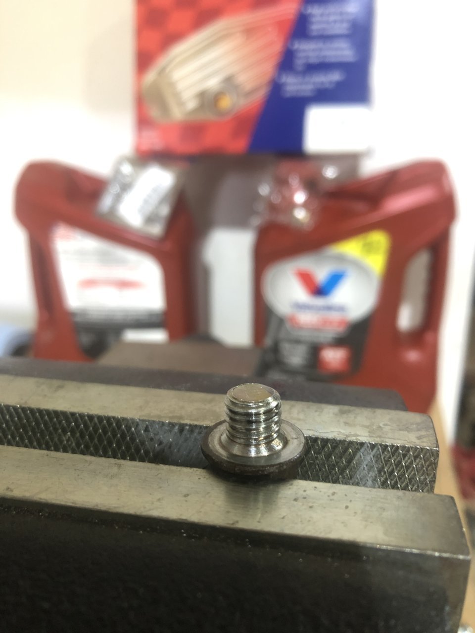

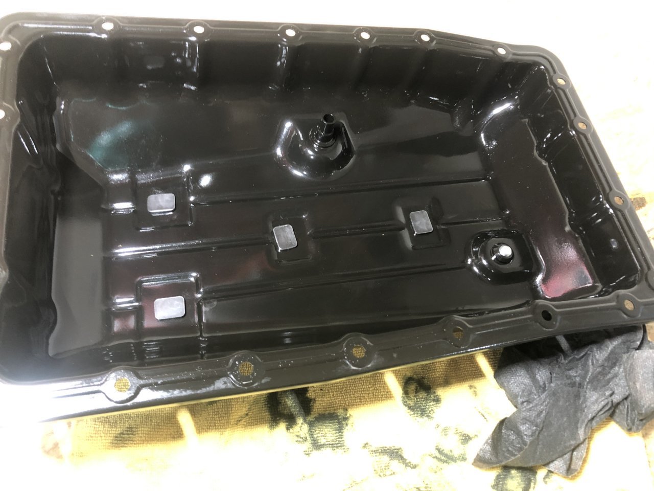

    Did this Transmission pan come from factory with an rtv or a fitted gasket?
  5. Nov 21, 2019 at 8:36 AM
    #45
    Buildit
    Buildit [OP] Active Member
    Nov 19, 2019
    #311149
    44
    Todd
  6. Nov 21, 2019 at 9:45 AM
    #46
    Buildit
    Nov 19, 2019
    #311149
    44
    Todd
    Pan was a grimy, had to wipe out a good bit
  7. Nov 21, 2019 at 1:01 PM
    #47
    Buildit
    Nov 19, 2019
    #311149
    44
    Todd
    Reinstalled pan with new filter, drain bolt, gasket and crush washers. I got drain/check level plugs to torque to 140in pound and left them alone:rofl:. It took about 5 quarts this time to get a trickle from level plug when it was up to temperature. Seemed like a lot more fluid this time, I guess because of dropping filter and pan and letting everything drip. This was a lot easier of a job than i anticipated, mainly attributed to all the information available here at Tacoma World.
