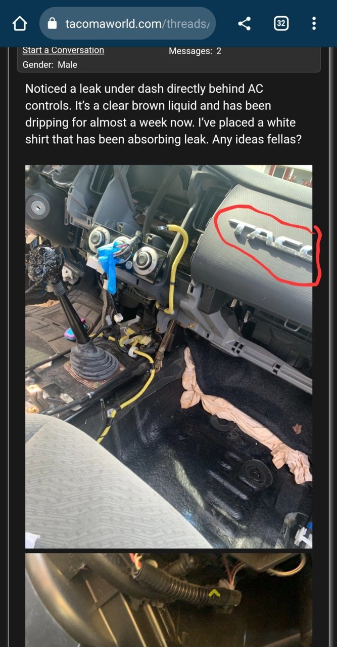

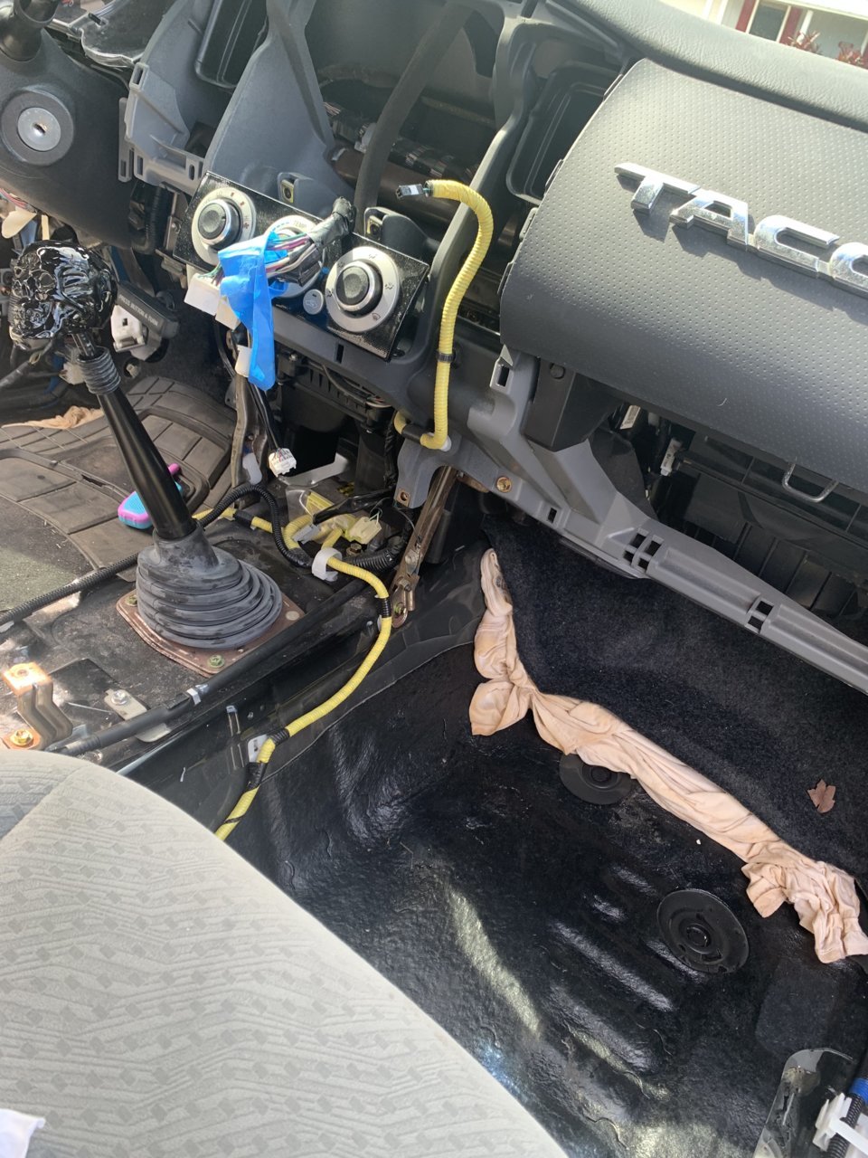

    Noticed a leak under dash directly behind AC controls. It’s a clear brown liquid and has been dripping for almost a week now. I’ve placed a white shirt that has been absorbing leak. Any ideas fellas?

    Rusty water or coolant

    if it is coolant, your heater core has failed. do not use radiator stop leak. it needs to be replaced.

    Sounds like it's the heater core.
    Also just a PSA it's not a good idea to have the tacoma letters on top of the passenger airbag like that, if it goes off anyone sitting there is gona have a face full of shrapnel.

    To replace the heater core yes, if you don't need the heater and you need to use the truck you can take the heater hoses off, buy a hose splice & a couple hose clamps (I believe they are 5/8 in), and connect the heater hoses coming from the engine together to bypass the heater core until you are prepared to replace it.
