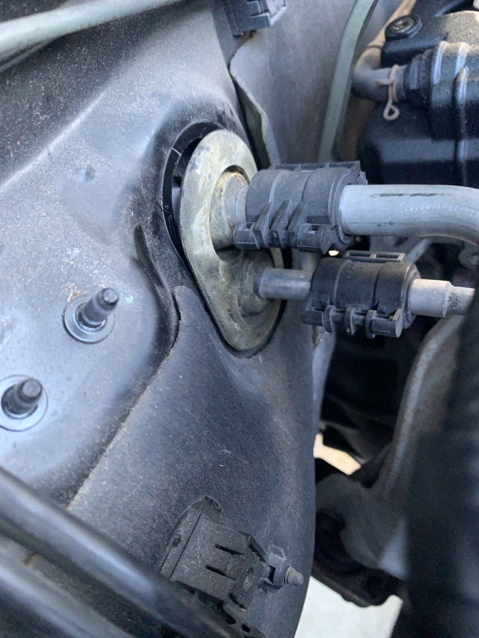

    Is there a special tool to remove these plastic clamps?

    Don't think so, I'm pretty sure they are just clipped together.

    Do you recommend oem cores? Or will aftermarket suffice?

    Go OEM if you can, aftermarket ones may or may not fit properly and I've even had a few leak shortly after and had to redo them.
