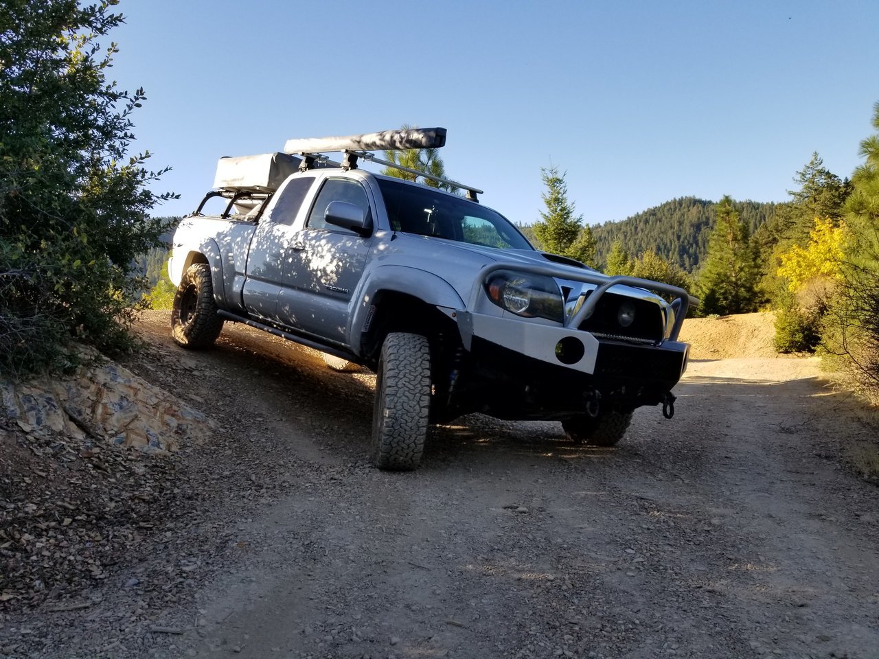

    20171014_161951.jpg My question is more of the overload leaf when it comes into play. I loved how my rear would flex without it , but with weight I bottom out easily. I'm forced to put it back in. So before I buy one, I would like to know which of the 2 would give me more flex ( original overload or the tsb)
