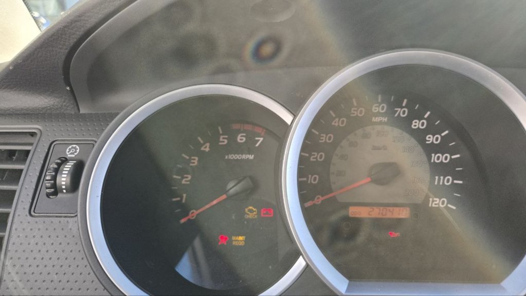

    So these are the lights that come on when I turn key to "on" position. All go away after start.

    545
    545 Well-Known Member
    Mar 21, 2019
    #287482
    1,319
    2015 Access Cab
    If they go away that’s fine, it’s just a self check so you can see that the light itself functions
    So after you start the truck all those lights go out?
  7. Mar 8, 2025 at 3:02 PM
    05prerunner270k
    05prerunner270k [OP] Member
    Mar 7, 2025
    #467295
    13
    Alex
    '05 Tacoma Prerunner RWD
    2" level
    Yes, after start all lights are gone.
  8. Mar 9, 2025 at 10:23 AM
    mynameisbs
    mynameisbs Active Member
    May 3, 2013
    #103386
    29
    Central Alabama
    2009 TRD Off Road
    You should be in the clear. Pretty normal for vehicles to light up like that with the key on but engine off. If nothing comes on with the engine running, and it runs and drives normally with no oddball sounds or vibrations you should be fine.
