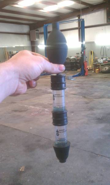

    Ok... So here's where we're at.
    1. As I mentioned before, I'm still leaning towards spark plugs as the issue. I haven't yet swapped any of them out, but am thinking of doing that this weekend.
    2. **Sigh**, all this talk of head gaskets shook me up. So, I decided to pay a local mechanic to give my engine a pressure test (not sure if that's the official name), and to do the coolant test that you guys mentioned. Yeah, yeah, it goes against my very being, but after researching it, the pressure test was more than I was comfortable with, and the coolant test seemed to have a fairly high rate of user error in the analysis. Plus, my guy was very reasonable (~$50). Good news! The results came back negative (hehe). No leaks, no exhaust in the coolant, yada yada. He further confirmed the P0306 and agreed that the spark plugs are the next thing to try.
    I still think its odd that my spark plugs, which aren't really that old at all, are an issue. I also find it odd that this is happening now after I did all this maintenance... Just odd.
    Anyhow, I'll keep you all posted on how things shake out (pun intended).
