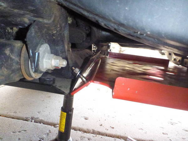

    I can post the pictures this weekend. It really wasn't so bad. Just mocked up the mid skid marked where I had to drill out the all pro IFS. They didn't line up perfectly so I had to get some longer bolts and just tightened those suckers down and made them line up. When I get pictures I could get the size of the bolts I used too. Really it wasn't that much more work if you got a good drill and bits to use to step up through the the sizes

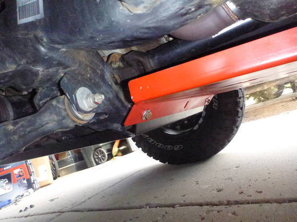

    Alright, got some picture to post so you guys can kind of see what I was talking about.
    This first picture here shows the gap betweem the AllPro IFS and the Mid
    Once you drill the the holes out on the IFS and get a bolt long enough to reach between the gap it wasn't to hard to tighten them down. The bolt I used was a little long, barely enough room in there between the bolt and that cross memember, I used 3in bolt I think, I wanted to make sure it was long enough but I think you could easily get away with a 2in on in there, I might go back and swap them out later with a shorter one.
    After that is all done and said though they end up going on pretty tight and snug, doesn't move one bit.
    The mid skid is a little wider then the All Pro IFS, when you are marking the holes to drill out make sure you have the mid skid line up the best you can. I noticed the first time looking to mark the holes that if you done do it right the holes will be right on the edge of the IFS and you wont be able to drill them out, but if done right I think youll end up with about 1/4-1/2 from the hole and the edge of the skid.
