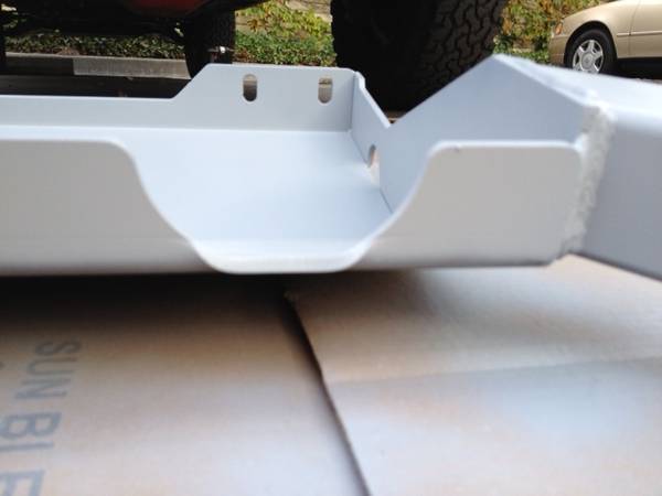

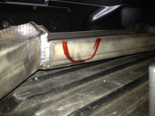

    bc I rerouted my tcase exhuast, I have to cut my tcase skid a bit because of the exhaust pipe coming from the driver side cat just like how the passenger side is cut :(
    you can see where the passenger side is cut on here (pic from OP)
    where I have to cut

    SJE and I ran into the same problem. My TCase skid is still sitting on the garage floor cause I didn't can a chance to mock it up and make the cuts before I left for vacation. I used a cut off wheel on an angle grinder and it worked out fine-Took a few minutes but not a big deal.

    yeah I'm going to do the same thing, but I doubt my cut will be nice and round like Eric's. It'll probably be square and I'll sand down the corners

    Yeah...I thought about getting my buddies torch to try and make it a neater cut- but I just don't think it's worth it. I cleaned SJE's with a grinding wheel to take sharp edges and burrs off it- It's up under the truck so I wasn't too worried about what it looked like.
    We trimmed a bit on his other side too cause the shop that moved our exhausts must have moved the pipe over just a little bit so he was getting a rattling noise and has a dent in the pipe now.

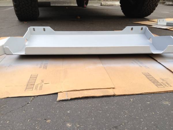

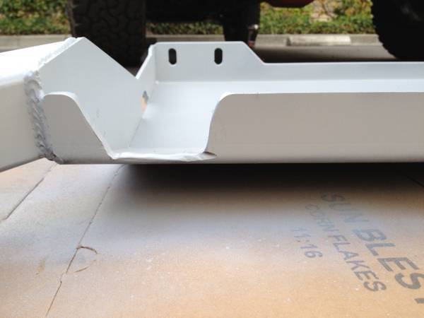

    Here's how I modified my tcase skid to make it fit my rerouted exhaust
    Relentless' cut
    my cut :(
    both
    and installed
    paired with AP IFS skid
