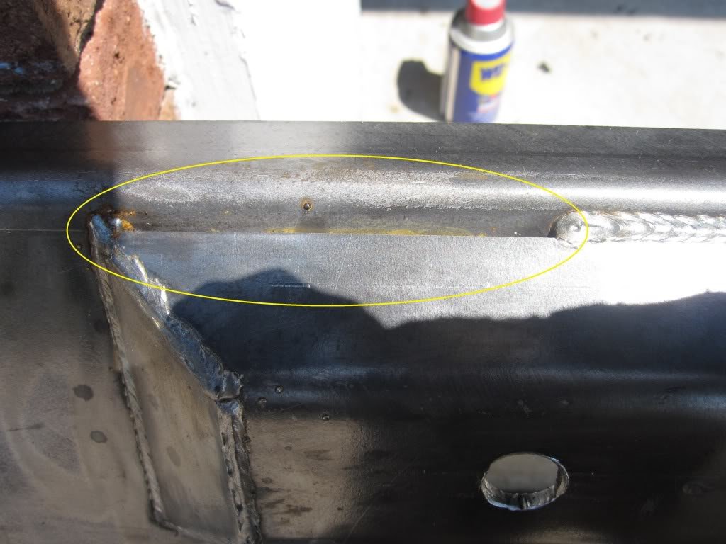

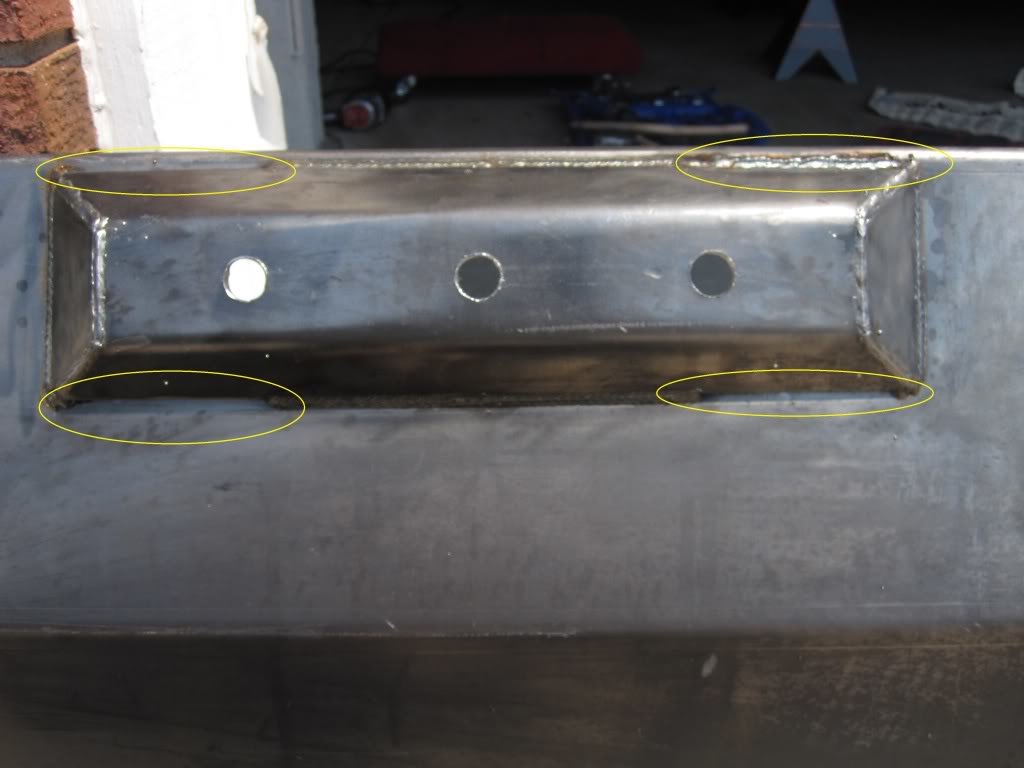

    Got my skids. BEEFY. Quality work. (My hardware made it too). FYI, I noticed on the T-case skid, the exhaust cutout didn't have the welds finshed. This was probably on purpose, to allow some water drainage, and prevent rust occuring in that area. See pic with yellow ovals.

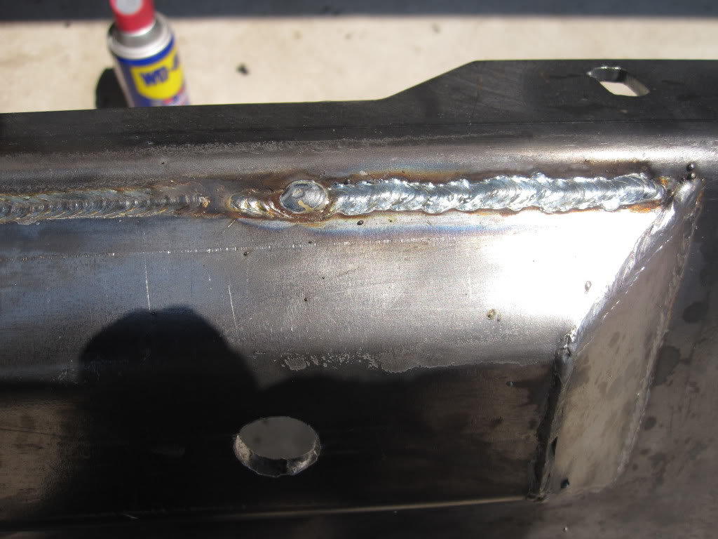

    I went ahead and finished the weld beads in those 4 spots. I put mucho bedliner on the backside (undersurface) where the water/mud would accumulate. Since the under surface isn't a wear spot, whatever you roll spray there should stay and prevent rust issues.
    Granted my weld bead shown isn't as pretty as the rest.

    so u asked about it not being welded then before u got a response u welded it anyway!? Hmmmmmmmm . . . . . . a little impatient perhaps

    Didn't ask ANYTHING. Made comment. Said I thought the unfinished weld beads were purposeful (probably). Either way . . . I finished the welds myself, b/c I think the unfinished beads would still be a place for water/mud to start rusting process. My solution: finish the welds, and make sure the under surface is well coated with a rust proof finish.

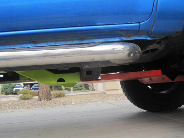

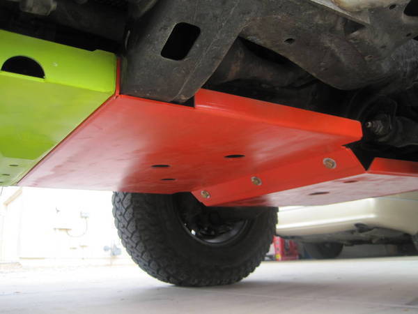

    Here is my intalation. This skid are heavy. :( Not to happy about that . My front it's sitting 1/2 lower.

    looks good! my front came down about 1/2" as well
